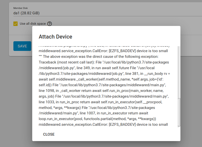

I received a second 32GB Kingston usb 3 flash drive - the exact make and model as what I am using/. wanted to attach to boot pool to mirror first kingston 32GB ..
I get an error whether I select 'use all disk space' or not. says device is too small (!) ...is there any prep needed to the flash drive prior to using it to mirror the boot pool ?
Suggestions ?
FWIW --> SOLVED this by finding 2 160GB sata laptop drives in parts box ... added first, resilvered, replaced 32 GB flash drive with second 160GB drive and resilvered again ... no issues...did latest update and rebooted ... all good (and NO MORE FLASH DRIVES! )...original 32 GB flash drive now shows up as 'unused' ---

Well, it looks to me as if you have fallen foul of the fact that nominally-same-size flash drives, even those from same manufacturer, type, etc., in fact do not all have the same storage capacity. This has been reported here on many occasions.
