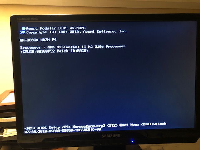

IMG_3599 shows what my system looks like with the FN 11.1 USB sticks inserted... it just hangs and won't initialize

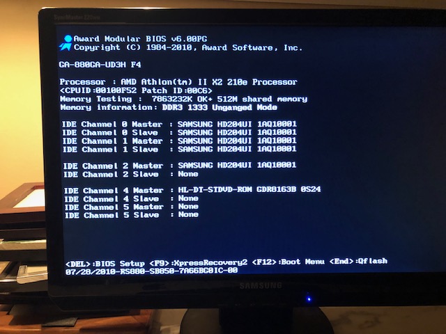

IMG_3598 shows what my system looks like without the USB stick in. Boots normally.
I've tried the tips on other blogs to try inserting the USB stick after initialization and then choosing it from the boot menu. That won't seem to work as the system pauses and gets stuck/crashes when I insert a USB stick anywhere during the boot process or when the boot menu is showing.
Just strange that it will boot fine from the older USB stick with FN 8.3.1, but it won't boot from four other sticks that have 11.1 on them. Very weird.
