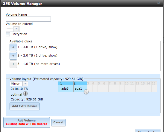

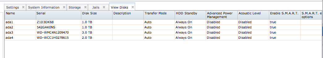

I decided to remove the raid card (made problems). After connecting directly to Hurd discs, installed the system. As shown in the attached picture I can not choose the raid array, please help.

As you can see in the pictures - the system does not allow me to select RAID-Z or any other form only Mirror
15,504
RAIDZ1 requires a minimum of three disks, RAIDZ2 requires a minimum of four disks, and RAIDZ3 requires a minimum of five disks. You've only selected two disks. And in any event, the capacity of a RAIDZ array will be based on the size of the smallest disk, so you'll be wasting some space with your mismatched disk sizes--a RAIDZ1 array with three of your disks will have a net capacity of only about 2 TB.

You can see that I have four disks - Although from different companies (other than 2). I want to understand, to make it possible to perform RAIDZ1 I need them to be the same size and from the same company?
15,504
Yes, I can see that you have four disks. I can also see in the Volume Manager window that you've only selected two of them, so the volume manager is only showing you configurations that are appropriate for those two disks. If you click on the + next to your 2 TB and 3 TB disks, it should add them to the pool, and then you should be able to choose a RAIDZ1 or RAIDZ2 configuration. However, it will likely complain that it isn't an optimal configuration because of the capacity mismatch.
It is not necessary that the member disks in a RAIDZ vdev all be the same capacity or the same brand. However, if the capacity is mismatched, your RAIDZ vdev's capacity will be based on the capacity of the smallest disk there. Thus, as I said above, if you create a three-disk RAIDZ1 volume, it will have to contain at least one of your 1 TB disks, so its net capacity will be about 2 TB. If you create a four-disk RAIDZ1 volume, its net capacity will be about 3 TB. You will, in effect, be wasting space (half of your 2 TB disk, and two-thirds of your 3 TB disk) until you replace your 1 TB and 2 TB disks with 3 TB disks.

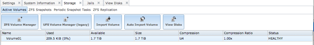

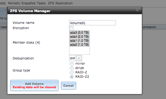

After reading, I decided to arrange the settings by manually adding hd as recommended.

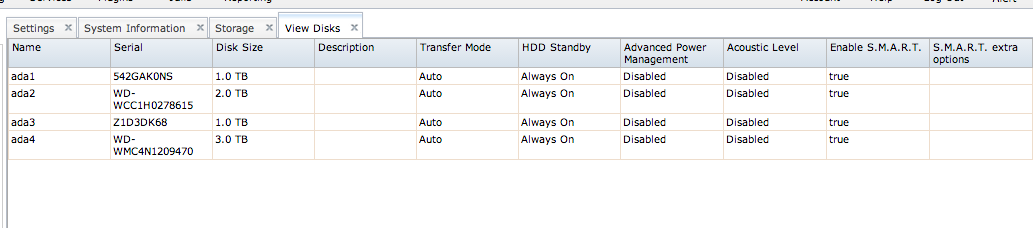

As you can see in the pictures, the total volume is 7 T hd, after adding Volume01, you can see the total volume of the hd is only 1.7 terabytes. Why?

After accounting for that, filesystem overhead, and GB/GiB conversion, your pool has a net capacity of 1.7 TB. That means that, ignoring compression, you can store 1.7 TB of data on it.
