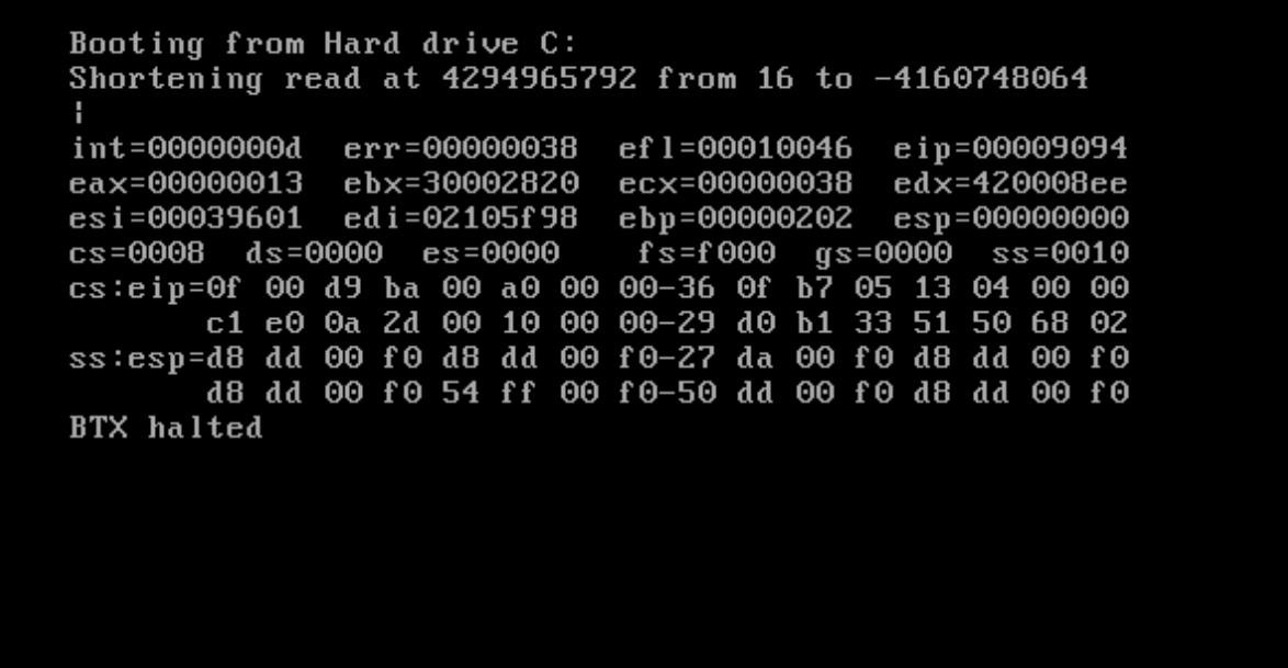

Hello FreeNAS community,
I have installed FreeNAS-11.3-U2.1 on a Dell PowerEdge 730xd with 2 x Intel E5-2680 v3 CPUs and 64 GB of RAM. The server has an embedded PERC 330 mini RAID controller card, to which two HP SSD S700 500G disks are attached.
I booted FreeNAS installer from a USB, the installer strangely did not detect the two SSD disks, although they are configured in Non-RAID mode. So I had to configure them into a RAID1 virtual drive and boot the installer again. The installer this time detected the virtual drive and the installation went perfectly well. I had to choose BIOS as the boot mode because for some reason if I choose uEFI the server halts during POST.
So after the installation finished successfully I rebooted the server but I got the following error once FreeNAS was about to boot:
Booting from Hard drive C:
Shortening read at 4294965792 from 16 to -4160748064
Then values of CPU registers are shown as you see in the attached picture.
Any suggestion about what is causing this?
Thanks in advance!

Since nobody could help me with this, I will try to find a workaround:
Can I install GRUB on a USB stick, boot the server with it and then load FreeNAS from that GRUB?
