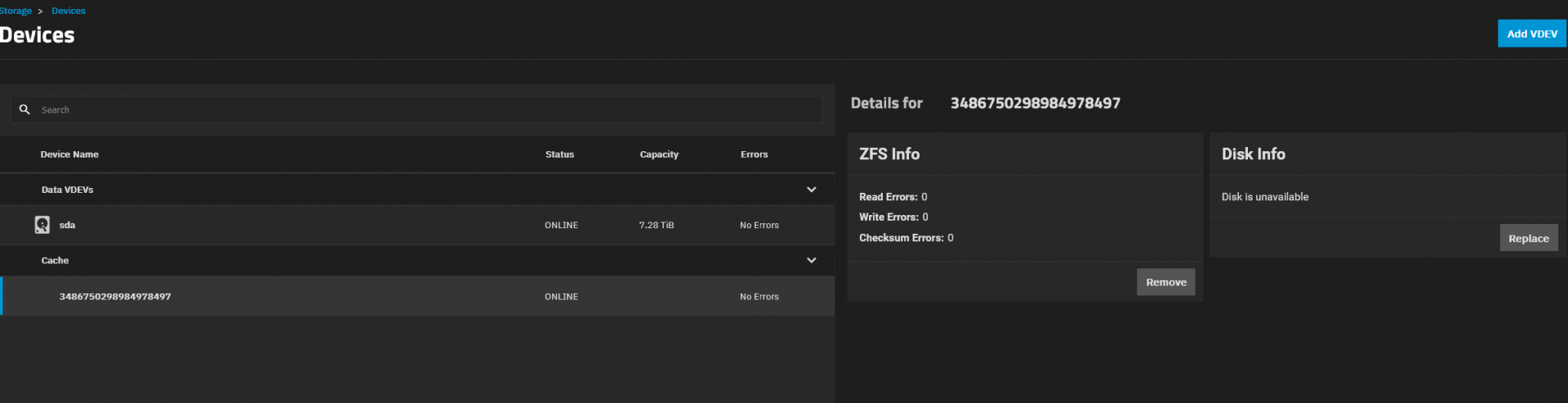

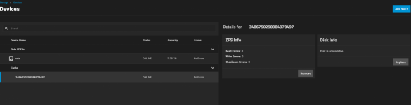

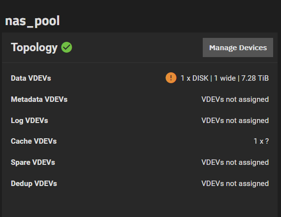

I have a test setup of Truenas Scale 23.10 working as a proxmox VM (4 Cpu threads/8gb ram). I have one pool with single 8gb WD red disk to which I plan to add a second one (I have a warning on the dashboard that the pool is a stripe with only 1 disk). I use the pool as smb share for photos/movies and as a iscsi dataset which is shared to proxmox with the idea to use for vm disk for some test linux/windows VMs.
I had a 256gb SSD laying around and wanted to add it as a cache disk in order to see if it will speed up operation of the vm disks stored on the iscsi dataset. The disk was added successfully and operates ok for 2-3 days. After that it appears with a question mark. Not sure which logs to check and whether this is some limitation/ issue with the ssd or the cache requires specific disk parameters. Also I can successfully remove the cache SSD and readd it to the pool but after a while the same thing happens.
Hope someone can explain why I am seeing the error. I suspect I am not using the system in the recommended way but still it is strange that the issue appears after a few days of operation.

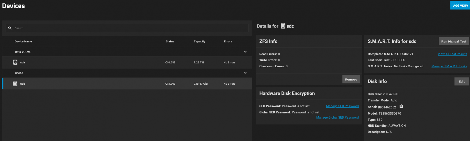

Here is the output when the SSD cache seems to work:
 pool: boot-pool
 state: ONLINE
  scan: scrub repaired 0B in 00:00:06 with 0 errors on Tue Dec 19 03:45:08 2023
config:
          sde3      ONLINE       0     0     0
errors: No known data errors
  pool: nas_pool
 state: ONLINE
  scan: scrub repaired 0B in 04:01:56 with 0 errors on Sun Nov  5 04:02:05 2023
config:
        NAME                                    STATE     READ WRITE CKSUM
        nas_pool                                ONLINE       0     0     0
          3e11c8dc-2653-4f36-8b2e-f401fbfea2ea  ONLINE       0     0     0
        cache
          sdc1                                  ONLINE       0     0     0
