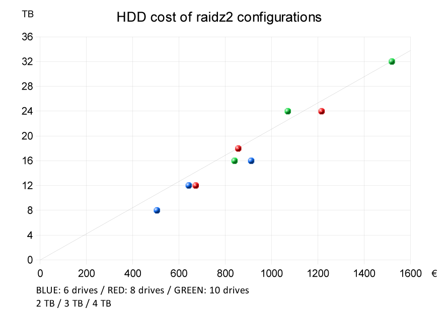

In the meantime here is another look at the hard drive configuration from a cost perspective:
(Note that I did not include the additional hardware required to run the server.)
Some observations:
- I thought the different setups would be much farther apart in terms of GB/€.
- My preferred setup of 8x 3TB comes in second place and has the best ratio under 1000€.

And why didn't you include the cost of the server hardware? Since you're going to pay that as essentially a flat tax to have a NAS, that weighs in very heavily as a component of the cost-per-usable-TB computation.
indy
Dec 28, 2013
287
Because the hard drive configuration does not affect the other components in my case.
The problem is that I can not project my future storage needs.
My solution is to get a solid foundation for the server and buy the cheapest hard drive space on top of that.
If/when my storage needs outgrow that server I will (probably) only change the hard drive configuration.

Approaching this from the other side, I could buy 50TB of space now for a very good overall space/cost ratio.
I would probably never use a fraction of it and that high initial cost would never see a return of investment.
As always, its not easy to find a happy medium.
I agree though that my approach and the graphic I made is oversimplifying things.

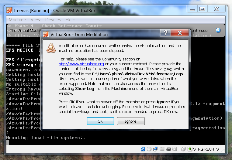

Lets hope this does not happen too often on the production server ;)

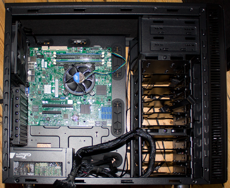

Indy:
I can't find it spelled out in the X10SL7-F manual, but another user commented on the ""fact"/assumption? that the CPU fan connector is so far from the CPU: at the corner near the SAS and SATA connectors -- obviously referring to the FanA connector, whereas you apparently have it connected to one of the other Fan connectors. Perhaps they are interchangeable from the electronic standpoint, but it does seem logical that the one labeled with a letter rather than a number would be for the CPU and the numbered ones for the (multiple) case fans.

jyavenard
Oct 16, 2013
361
Indy:
You could plug your CPU fan on any of the pwm connectors. However, the BMC is controlling the speed of that fan according to the CPU temperature. If you plan on running the fans at full speed, then it doesn't matter. Otherwise use it only for the CPU fan.
The fanA connector, if you check a supermicro typical chassis is the fan on the left. They have a fan setting defined to have automatic speed for all fans except the fan connected to fanA.
That insure extension cards, if any are kept at maximum cool.
indy
Dec 28, 2013
287
@z300m
Now that you mention it, I cant find it in the manual either.
Pretty sure though that jayavenard is correct though, I remember reading that somewhere.

indy
Dec 28, 2013
287
Not a big fan of hot-swap cages personally because they lack vibration damping.
I rather have the hard disks mounted with rubber grommets and cables to make them a bit less noisy.
