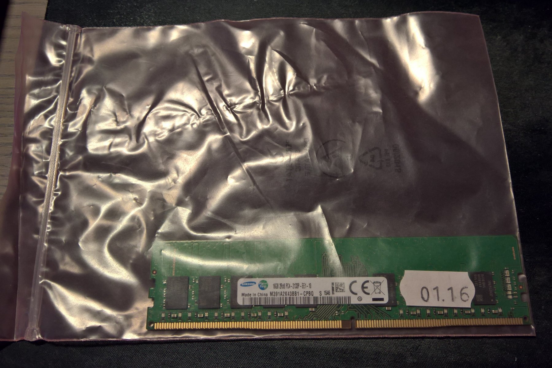

Not at all. Both Samsung and Hynix have 16GB DDR4 UDIMMs.

I'll consider the 6300! It's not too much more, it may depend on if I upgrade the backup to ECC or not. As for the DDR4... Huh, I actually checked Samsung's site after hearing mention of them before and didn't see anything. Must not have looked hard enough. And for modular cables, I think I'd be using all but the PCIe cables from the 360w (need a molex to power the fans) so not sure if modular would be that big for me. The splitter is a SATA to 3xSATA and looks to be good quality, I'd never use a molex to SATA since it's those I always hear horror stories about yeah.
Their site is close to useless, unless you're $_big_company looking to acquire DIMMs by the thousands. But trust me, they do:
Allright, I can look up that model number. Still, I do like Crucial and have seen others who've said they used that stick in the ASrock C236 ITX boards without issues.
Any of the big three (Micron/Crucial, Samsung and Hynix) is generally fine, though it's best to get something from the QVL.
