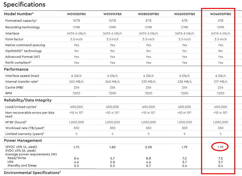

I am considering the Red Pros because the data transfer rate is so much greater than the Red Plus (217MB/sec v 180MB/sec). I'm no engineer but it looked like the case PSU would deliver adequate power for the Pros. The case spec lists output as "+12V Max: 28A / Min: 0.1A" If I'm reading it right, the Pro spec sheet (below) lists peak power consumption as 1.79A at 12V. So it seems four drives would peak at 7.16A, well within the 28A max output of the PSU. Am I missing something here?
I love the idea of upgrading the case fan on the initial build. I'll research fans now. Also, mod'ing the case later on to add an additional fan is well within my wheelhouse. Great idea, thank you.
I really need to know if I'm reading these power numbers correctly.

...I should acknowledge the important point that the Red Plus heat output has to be a lot less than the Red Pros given the difference in average read/write power consumption: 7.2W for the Pros and 4.7W for the Plus. That's 53% more power draw for the Pros! Must be lots more heat too. Plus would definitely keep things cooler.
Well, count on 3A per disk, but it should be perfectly alright. As long as you don't do something crazy like sticking a 300W CPU in that tiny chassis.
I was answering a heat related question, not power supply capability, I already said the power supply should be fine for the drives you selected.
Exactly my point. Slower drives draw less power (generally) and produce less heat. Again, answering your cooling question.
