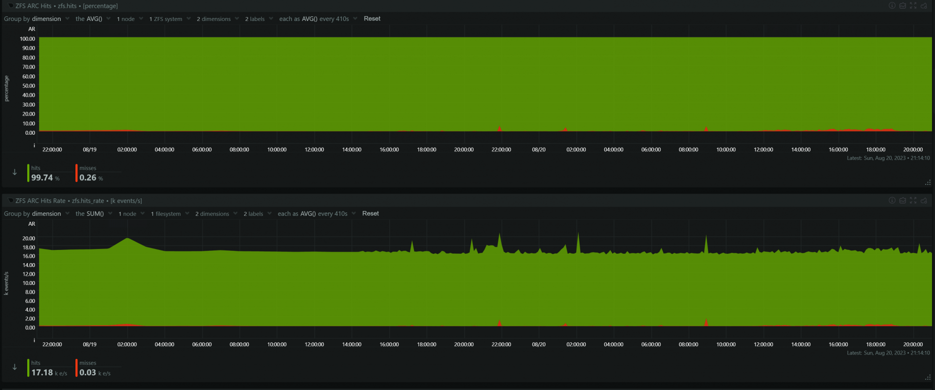

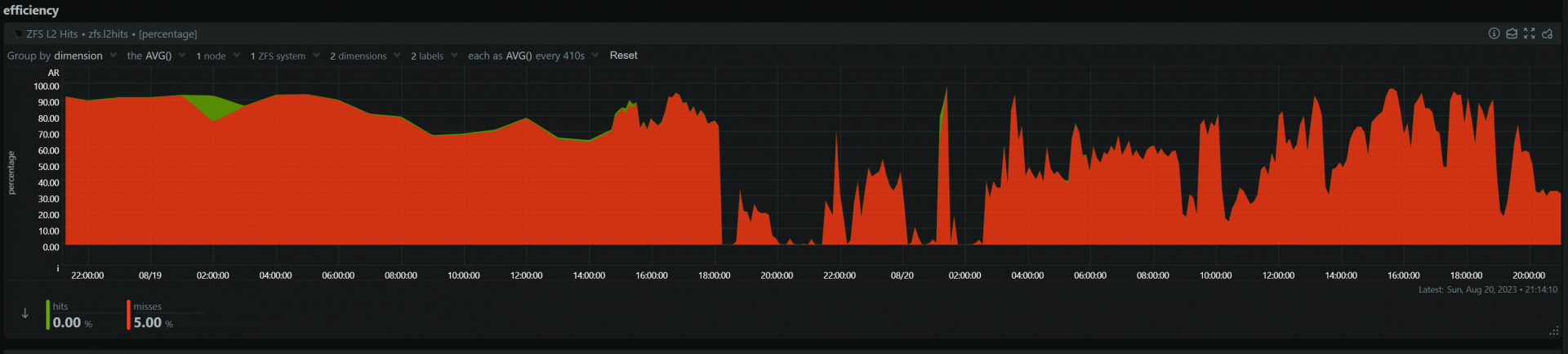

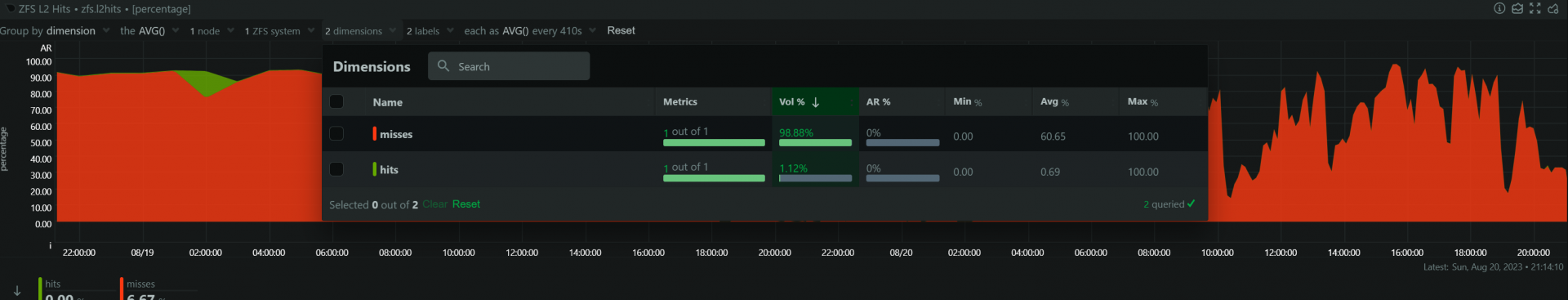

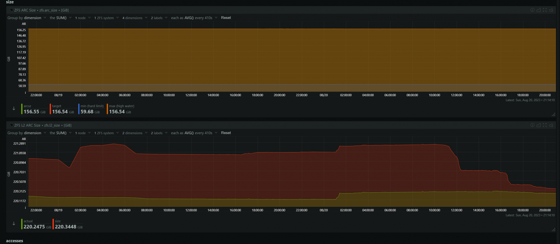

In defense of @jgreco here's some real evidence in favor of his argument. My HomeLab environment. Sample size, 2 days. Relatively light workload. I'll kick it up to 11 for a few days and report back.
Both my ARC and L2ARC are populated nicely..
My ARC hits are fantastic..
My L2ARC hits? Abysmal.

Thanks. Which argument would that be? Your ARC is way larger than 64GB so if anything this shows that is no silver bullet but rather L2ARC performance depends on many other factors. Your hit rate is indeed intriguingly low… what type of data goes into it? What are your settings for l2arc_write_max and l2arc_headroom?
The argument that the argument is pointless for homelab users because L2ARC hit rates are generally going to be low and not going to help performance...:wink:
I didn't want to hear and accept that argument either. Thats why I have an L2ARC.
