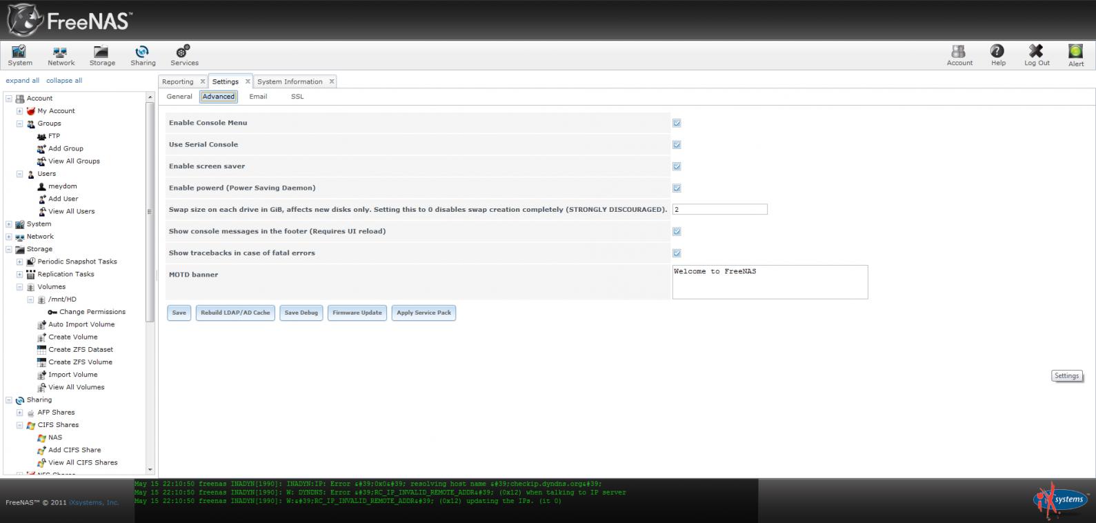

Hello
I am experiencing the exact same problems....
I tried to follow your guide in how to fix this, however I could make any of the changes you suggested. I cannot access the Auxiliary Settings. As you mentioned, I tried to enable the Advanced Settings in the settings/system, however there was no such check box and label. Any suggestions, how to change the settings??
The loader.conf in the boot directory has got no code similar to yours at the moment. I tried accessing it using winscp in ftp
I am using the build: FreeNAS-8.0.4-RELEASE-p2-x64
Best Regards

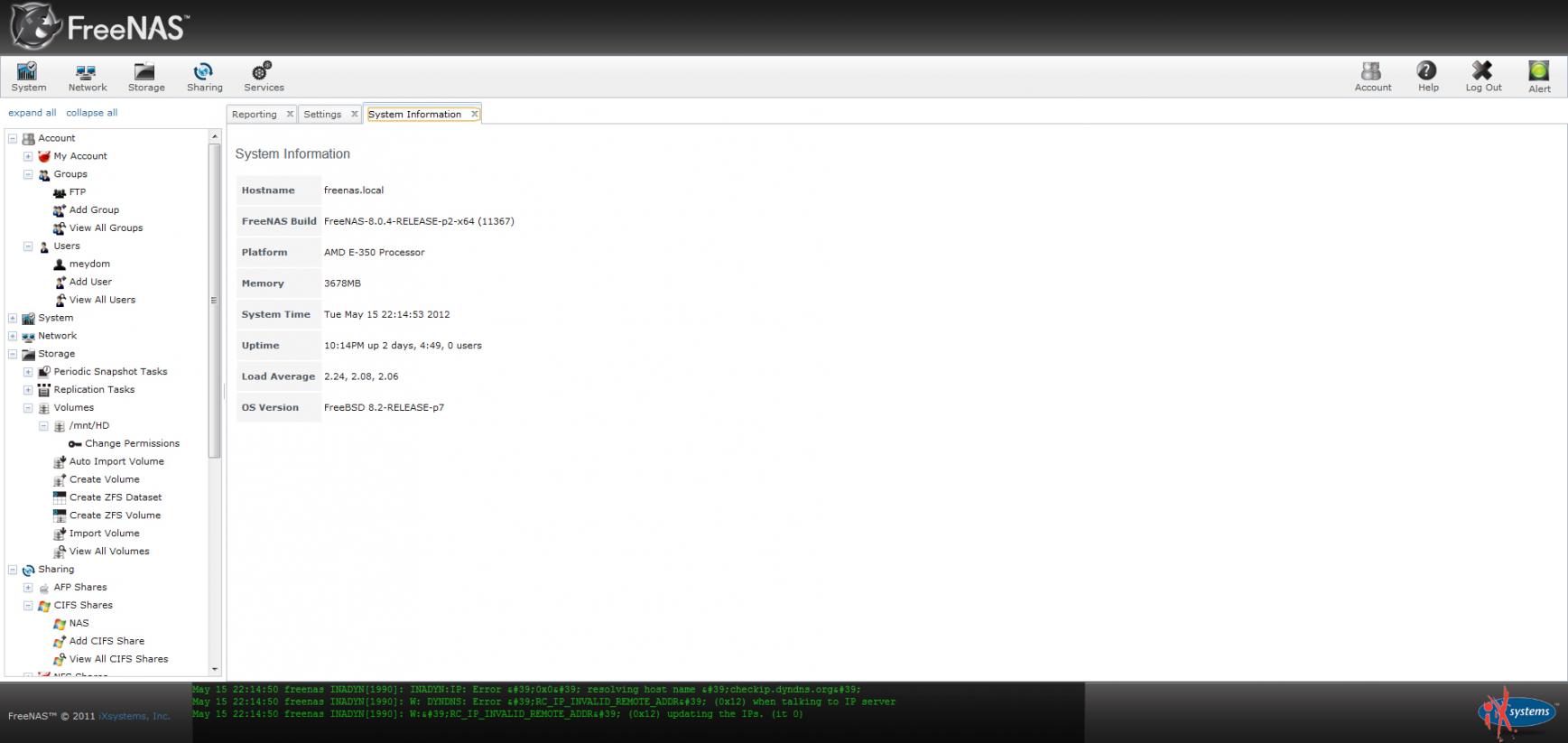

Hi
Thanks for your reply.
I checked again, but strangely I do not have those settings. This can be seen in the screen-shots. One shows the lack of the options and the other the firmware number.
I tried the tuntables, and I do not feel any difference with the browsing speed. I have 4gb of ram therefore i halved all of your values. Is this correct?
Thx a lot!!
