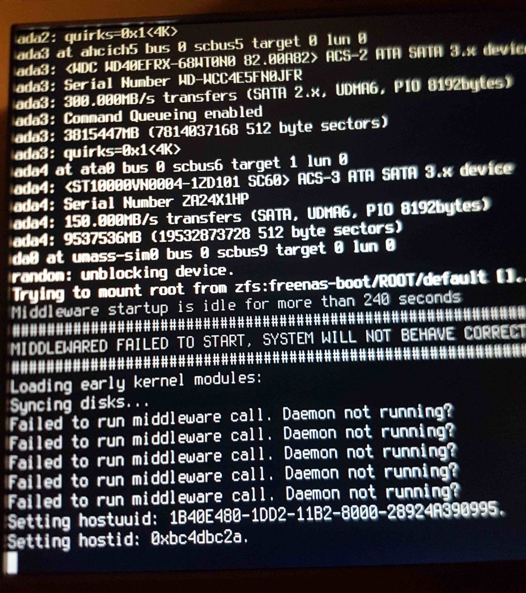

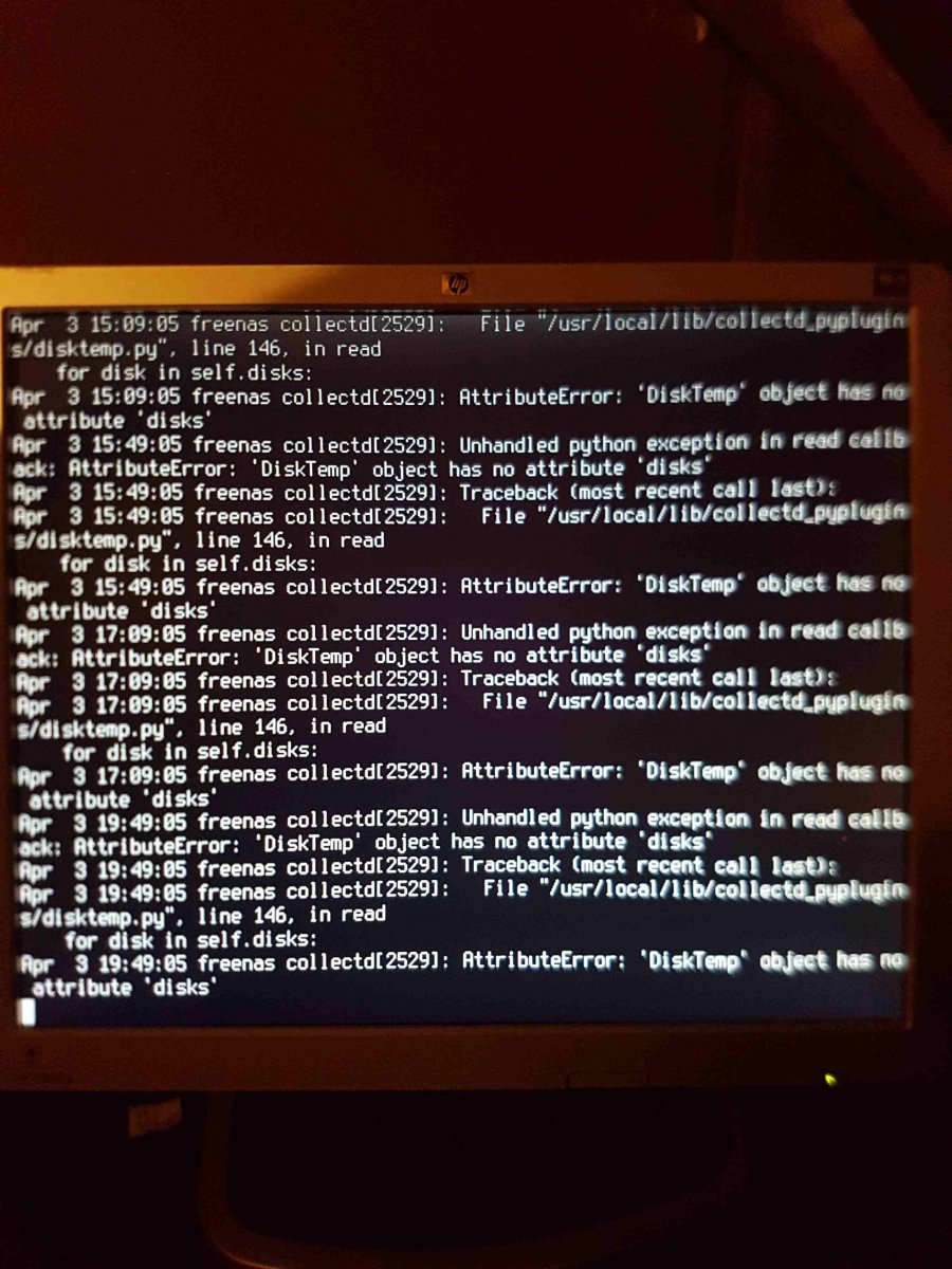

The next pair of USB-sticks seems to work fine: I use Rufus to create the bootable usb-stick, and after some time: "installation successful". But trying to boot the FreeNAS-11.2-U3, it gets stuck:
  1. Trying to mount root from zfs:freenas-boot/ROOT/default
  2. freenas collectd[2529]: AttributeError: 'DiskTemp'
Please see the messages attached for more details. There are certainly screenshots missing in between those two, but progress was really slow, so I got tired of sitting and waiting in front of the screen... So the second screenshot is taken "the day after".

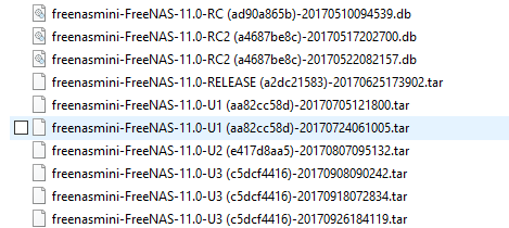

I do backups of my config-file quite frequently - how can I tell which one will work with a certain FreeNAS-version?
All my saved config files have the FreeNAS version in the filename - file extensions were .db until 11.0-RELEASE when they changed to .tar :
Don't yours?

  • yes, my stored config-files have similar names. So this means, that any config-file should work with the latest freeNAS version?
Choose the latest known good version as a starting point.
