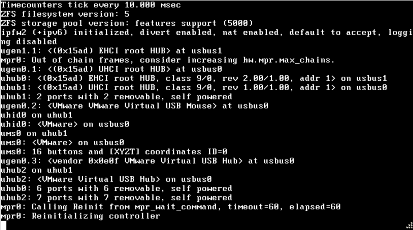

Hi guys,
Tonight, I updated my MainReplica from 12.0-RELEASE to 12.0-U1 update. After reboot, system stucks during boot screen.
Here is some details;
Chasis: Dell R730xd
CPU: 1x Intel(R) Xeon(R) CPU E5-2695 v3 @ 2.30GHz
RAM: 128G
OS: ESXi 6.7.0U3
HBA: Dell HBA330 mini (Passthrough)
Adapter Selected is a Avago SAS: SAS3008(C0)

During bootup screen, it stucks with Last line in console such as "mpr0: Reinitializing controller".
After some research, I found something about X2Apic mode on this thread : https://www.truenas.com/community/t...d-stuck-mpr0-reinitializing-controller.85999/
I'll try asap but now, I set active boot env. to 12.0 RELEASE back and it works.
X2Apic already disabled on my system since it was installed.
So I could not update my truenas to 12.1 but 12.0 looks fine for now.

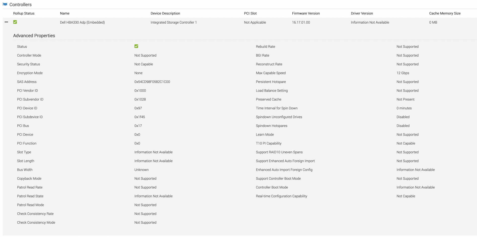

I hate to bring up a dead thread but I am having this issue as well on my newly deployed Dell R440. I won't have time to test it until this weekend, but I think I found an error in my setup that fixing could solve this issue.
My HBA330 card will passthrough and function, however sometimes it takes multiple reboots of my trueNAS vm (deployed on proxmox) in order to pass the "mpr0: Reinitializing controller" phase.
In my to-do list prior to launching my server, I flashed the Dell H330 Mini with HBA330 firmware, for obvious reasons. I apparently wasn't careful enough and just now realized that I probably didn't flash the proper firmware to the card, as my card is a Mono Mini and I vividly remember flashing the normal (pcie) HBA330 firmware to it... no big deal I just need to reflash with the proper firmware. I also noticed that in the iDRAC9 settings of the server, although the card is detected and works, there are numerous properties just "not supported" or "information not available". (see attatched screengrab)
I'll get to work on this in a few days and update this reply to let you know if it's a remedy to this issue... I know it seems like a mistake many wouldn't make, but you might want to double check and make sure (if you have an originally H330 card) that you flashed the proper form factors firmware...
