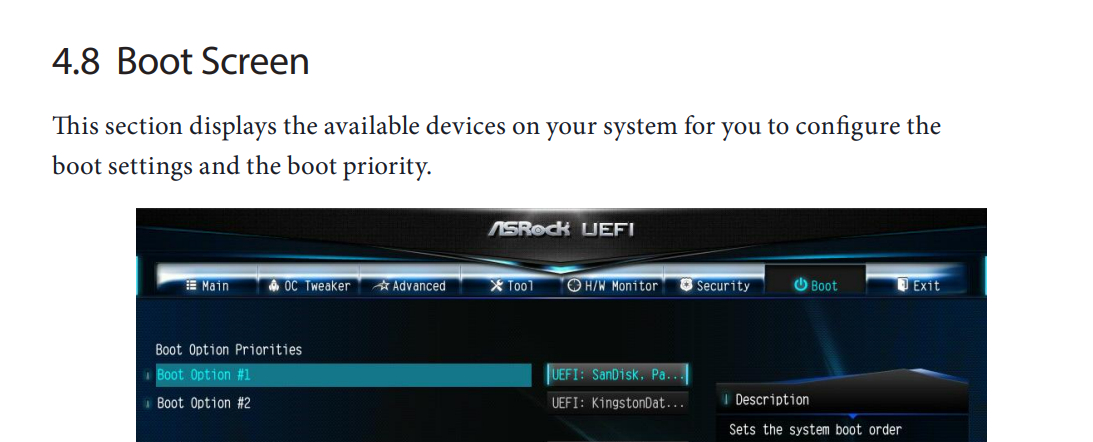

Not quite - you will need to enter your bios and ensure that the correct device is selected for boot.
From your mobo manual, looks like that would be here:
I would test to see if it will indeed failover from option 1 to option 2 - it may not, only selecting #2 if the device is not present in #1
Here's the catch: I don't have an APU, nor a graphics card without a power connector, nor has my MB IPMI... So I cannot get to the BIOS (unless I buy a graphics card just for this).
I've experimented switching USB ports with one and both keys and it's always booting... I can't say more.
Redcoat
Feb 18, 2014
2,925
So it seems yours is "failing over" if you have good USB thumb drives, which is good.
