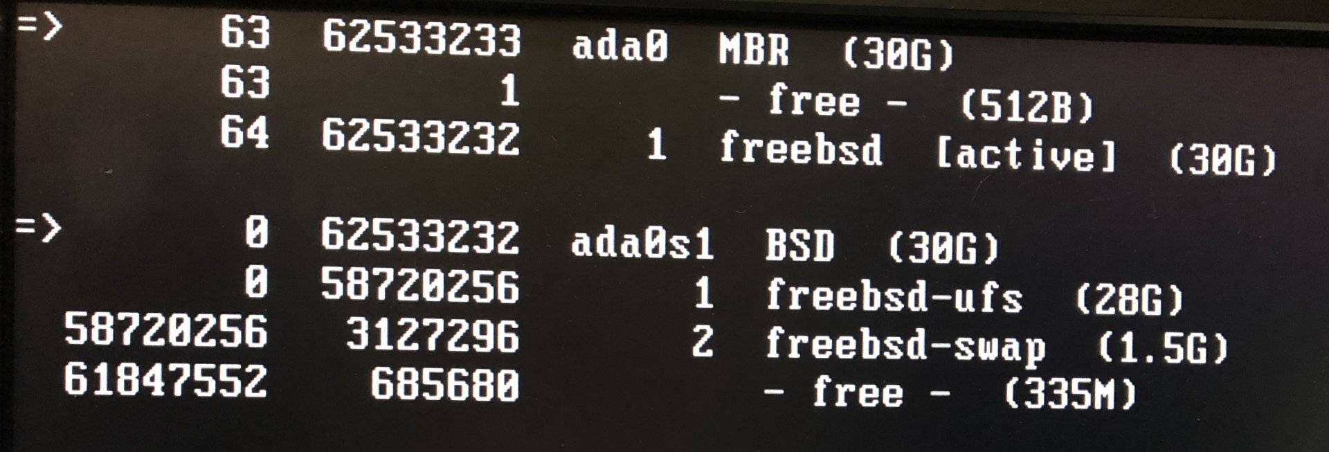

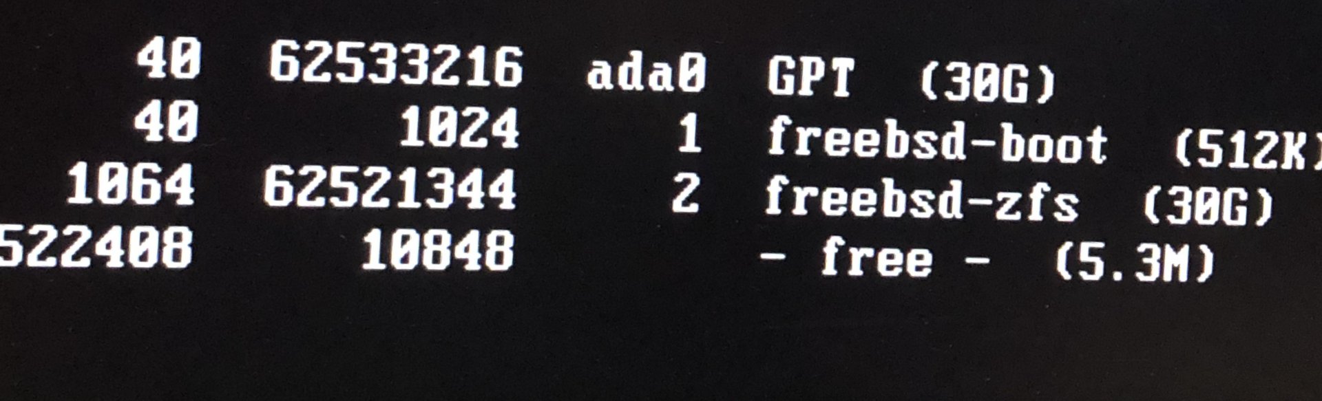

I've attached two screenshots, one of the disk layout produced by TrueNAS (that doesn't boot) and another produced by FreeBSD (that does boot), in case that offers some insight into why one succeeds and the other fails.
