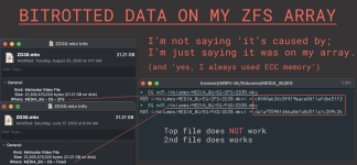

I then realized I cannot know for certain the reported file size is correct, bc things like BT's "reserve" the capacity on the drive prior to DL-ing.

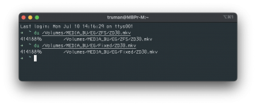

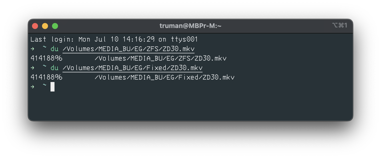

For this reason, I used "DU" command "disk usage" which calculates file space in 512-byte units.
There are still other possibilities, but, these were still equal also for the test file I chose for my example.
Bc the file's corrupt, had md5 been inadequate to show the discrepancy I'd've then used SHA or SHA256.
Pictures showing both the reported sizes and DU sizes were the same, and that only the md5 differed are attached.
But ... the files previously worked ... so it's pretty unlikely they were incomplete, and instead likely just had corrupted data.
