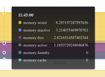

trevorb
Aug 13, 2013
24
Rebooted FreeNAS server and everything came back OK, with VM happily running.
Just over 8 Gb of memory in use and stable for a few hours now.
I'll let it run a little longer to see if things change an then may restart the VM to see what happens....
