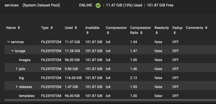

I have a TrueNAS 12 pool running on an SSD, called services and used to store the jails:
What would be the best way to backup everything, in case the SSD breaks and I need to replace it with a new SSD? I currently run few official plugins with their own dedicated jails. Thank you.
