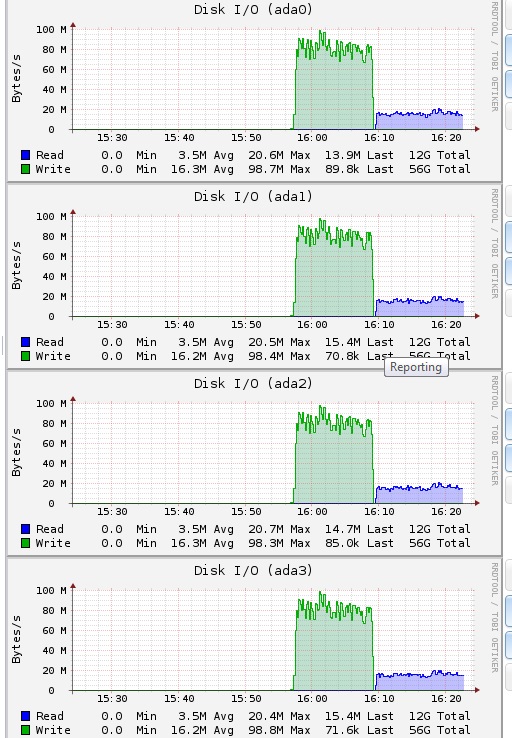

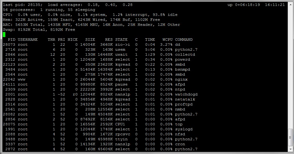

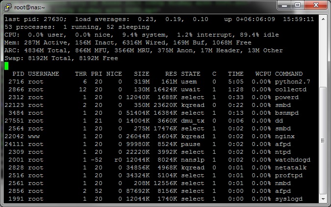

TOP coomand data and graphs from disks attached.

CPU doesn't seem to be the problem nor does ram as shown in the screen I've attached in the first post. Performance isn't really an issue but I think with this setup, I should have 100 MB/sec read and write. Don't you?
Well, to be honest.. you haven't yet provided ANY numbers involving transfer rates yet. Yes, you provided the reporting screenshots, but that says nothing else except the disks do about 80MB/sec. That's NOT an indication of transfer speeds across the LAN(which is generally what people care about).

I agree with you. Maybe I didn't explain myself very well. Those numbers are not from single disk benchmark. This are values I'm getting from writing and reading from my raidz2 pool. You say 30MB/sec. I'm not even hitting 20 MB/s per disk. Am I seeing this wrong? btw, transfer speed with nfs hits 30-40 MB/s from nas to linux server and macbook on gigabit network.
