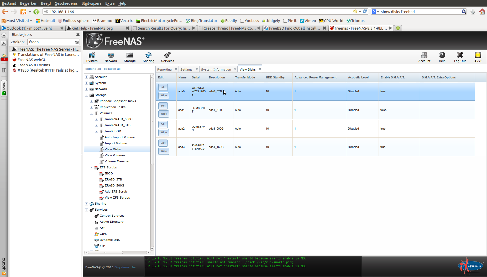

Now the really odd thing is that the web GUI has the disks mixed up and one disk is missing.
ADA1 is showing the wrong serial because it is from one of the 500G drives! But it still lists it as a 3TB drive...
See screenshot of the GUI: Schermafdruk van 2013-06-16 12:16:32.png
