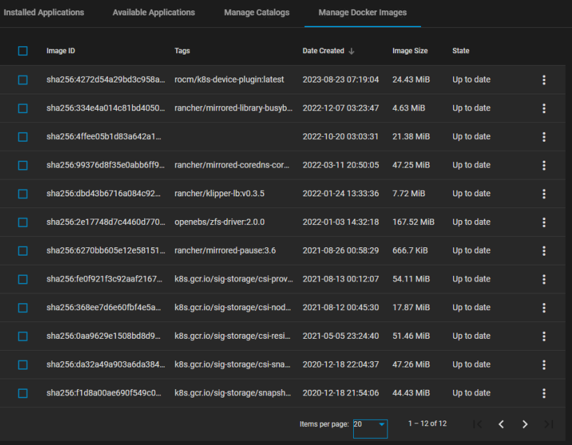

  7. As I was saying, I wasn't even able to install the apps, so I not only have a problem with two RSyncs not talking to each other, but also with apps not installing.
Now I'm doing this using FreeFileSync on Windows. Every day I read the shared folders on TrueNAs and write to the shared folders on QNAP. It's not a Backup, but at least I only transfer the differences.
If I could do it directly from TrueNAs at least it wouldn't take up the LAN bandwidth.

Then you need to post the steps taken and the errors you are getting so that help can be provided. I would expect a backup to Qnap can be done but who knows where to start without details.
The way I delt with my 1.2 mbps upload speed that I had for a few months (but don't any more) was this. If I had a VM or whatever and there was no way that could possibly be uploaded, I didn't. I backed up the most critical files offsite, and even if the VM was critical I skipped it. So, I tailored my backup set to something where an incremental could be done over night. It worked fine. Sure, my VM (in your case) couldn't be backed up, so, it was backed up via some other method. You don't have to backup everything with every method necessarily.
My nightly Kopia incremental backup runs < 5 minutes. It doesn't include my 99% static media library of course, that has a much different technique.
Regarding looking for backup apps, have you considered the Truecharts catalog given you don't want to use docker images?
