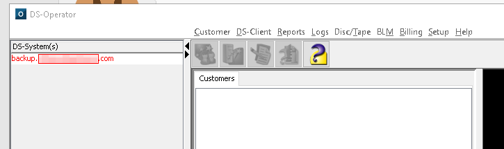

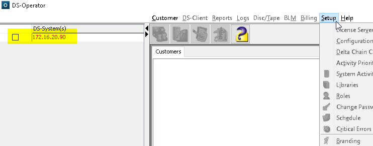

Let me tell you all the story again. I followed Dan's guide, able to get the plugin installed without any error, downloaded the iso file ... launched the management console bla bla..... then I was stuck at "Check the box next to the "asigra" entry in the left-hand panel. Login as root/root". I found no way to get this IP green and to be able to check the box to keep moving ahead, everything else is grey out, see screenshot below.
The only thing I can do is that I can ping the jail's IP.
Is there any trick here to get this stuff works? Do I need to open or forward any port?

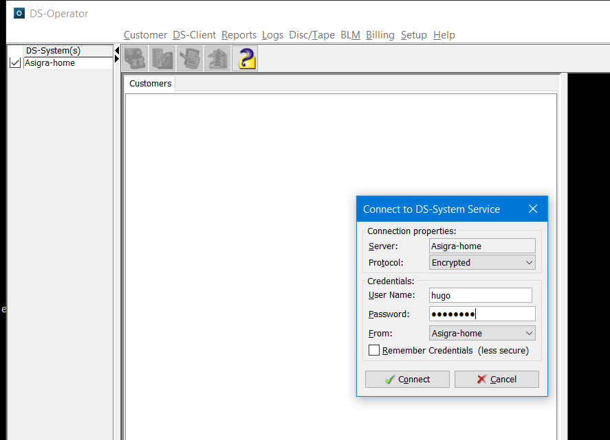

hugovsky
Dec 12, 2011
567
You need to use the user and password you created with the jail. Or you can create new one using jail shell.. root user only allows to manage users that you have to create thru jail shell. Users created can have any permissions given by root in DS-Operator.
Just to clear:
DS-User: used to login in local system. On windows, should be an admin account.
DS-Operator: used to login in remote system (asigra server in Freenas server) . On windows or othes, should be an account created in the asigra jail on freenas
EDITED to clear some points.

Hugosky, thanks for replying and providing the screenshots. My problem is that I'm stuck right at the DS-Operator, unable to get it talk to the server. I tried the DNS resolution to the asigra within the pfSense, see screenshot, but no luck though I can ping both the IP and the FQDN.
When I created the jail, I just simply run the plugin within the FreeNAS WebGUI. I recall that the setup did not ask me to provide any account, username or password, then It said the installation is successful!!???
Which port did you use when you were doing the DS-Operator Initialization?

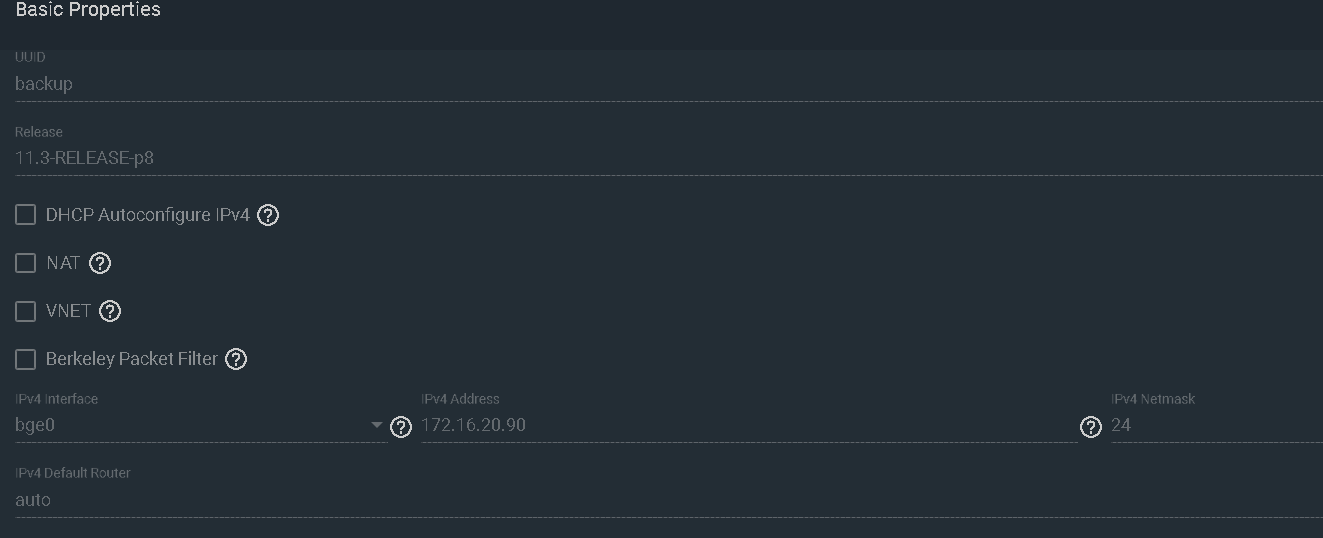

What are your network settings? are you using dhcp? these are mine. I'm also using one physical interface for the jail. Can this be the culprint?

I'm using a dedicated NIC for the jail with static IP. Not sure if this is the culprit. Please see screenshot.
mapcevn
Jul 10, 2019

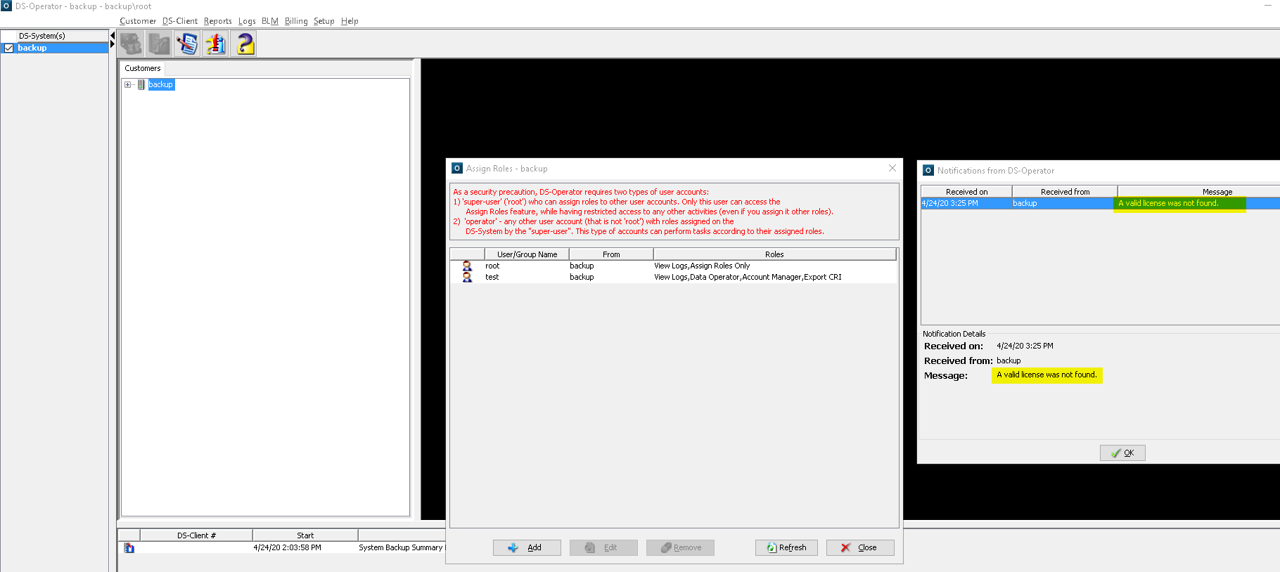

40
I switched to DHCP and it works!!! It's baffled me when the software refused the static IP and the dedicated NIC, but it's OK at this moment as long as I can move this forward. However, I'm stuck at the licencing stuff, please see the below screenshot.
The licence server in the SETUP menu is grayed out. I guess you came across this one too, and I'm wondering how you jumped through this hoop?
mapcevn
Jul 10, 2019
40
Ahhhh, Dan's guide helped me again. I log out and login again with a new user created with his guide and I was able to go through all the process on server side setup. Not sure how the client side will look like, but at least there has been some progress. Thank you, Dan and Hugo.

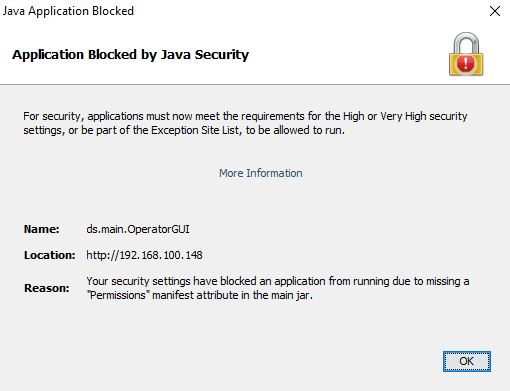

How in the world did you guys get this to work? I've gotten as far as installation of the plugin, but when I click on Manage, Java refuses to let me run the DSOP.jnlp due to security concerns (see pic. below) How do I get past this? When I registered with Asigra, the email I received stated: "You will receive another email with instructions on how to set up the Asigra Plugin for FreeNAS". I never got the second email. Does this email contain some sort of instructions or special Java version to be able to setup the DS-Operator and DS-Client?
I'm a week old FreeNAS user and mainly PC user with no programming knowledge at all. I can fallow instructions very well though. That's how I got thus far with this Asigra installation.

You need to add a Java exception for the URL that is being denied, i.e. http://192.168.100.48, in this scenario. For information on how to do this you can check this link out: https://java.com/en/download/faq/exception_sitelist.xml

Thank you @Kevin2020. I tried adding this exception and it didn't work because I included just the IP address without the http://. I'll try it this way and will keep you posted of any other issues I encounter.
Thanks again.

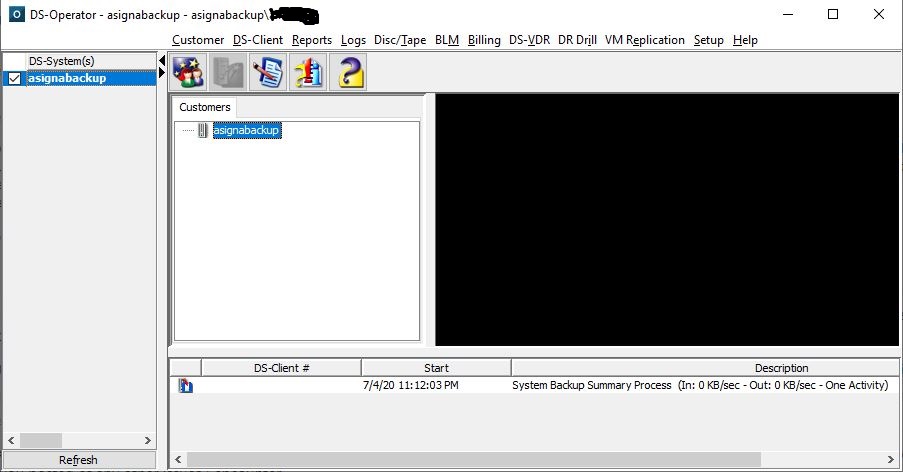

I added the exception to Java and was able to complete the setup following @danb35's guide. This is what I have:
All I need now is the DS-Client for my Windows machine. I'm still waiting for the second email from Asigra. Is that where I get the Client software mentioned by danb35?
