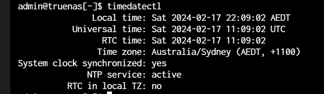

I've used 'timedatectl' to check my time settings (attached). Are these looking how they should for Australia vs UTC?
