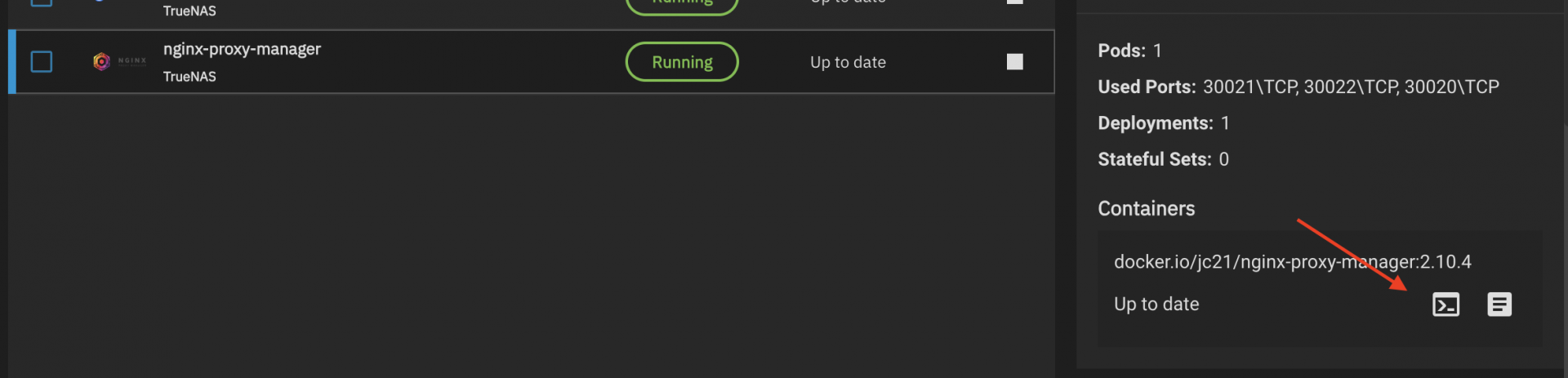

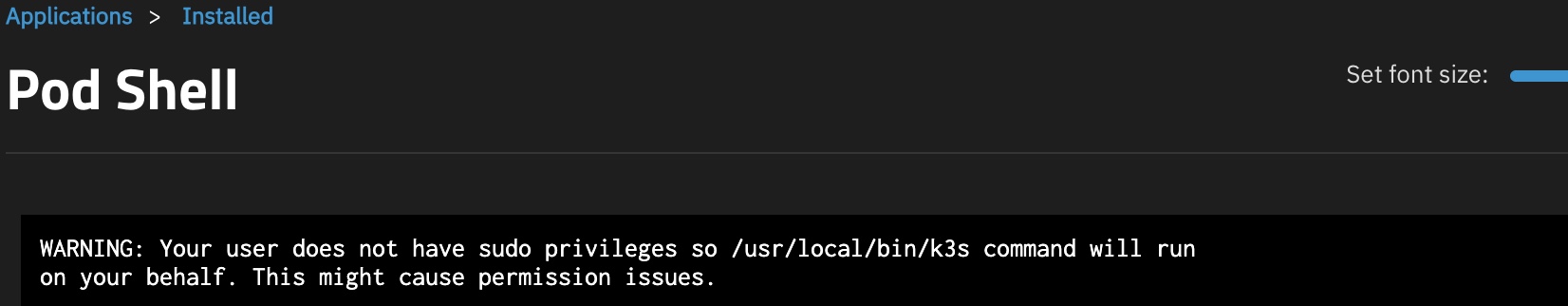

so i have been fighting this and randomly opened the docker shell and got the message in the picture, then returned to application list and it was deployed. replicated a couple times by deleting app. i also pointed host path to a ssd. sorry if this is gibberish but the app is deployed and accessable for me now.
