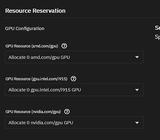

I have enabled Apps Service (Docker) and deploying application from Discover section works as expected - I can deploy the applications, the go to a running state and work.
However when I try to deploy any custom app (any public image from Docker Hub) the state stays at "Deploying" and never gets to "Running". Under the custom app Details section I have a recurring following Related Kubernetes Event:
Allocate failed due to no healthy devices present; cannot allocate unhealthy devices amd.com/gpu, which is unexpected

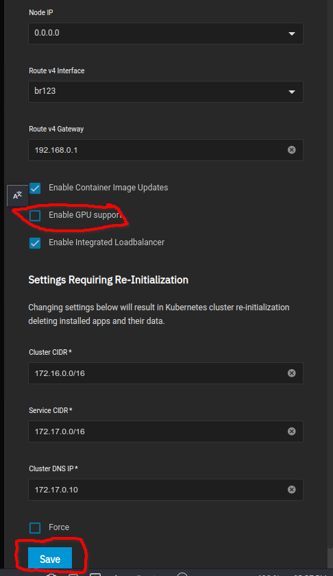

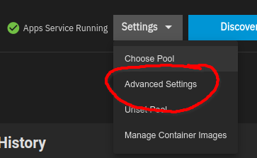

Try doing the following:
Access the advanced settings for apps:
Next, within the settings, uncheck enable GPU support and click save.
If you are on the most recent update for Scale, you may need to click the force button before saving. I had to do that as the most recent update seems to have issues with bridge interfaces.
