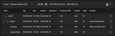

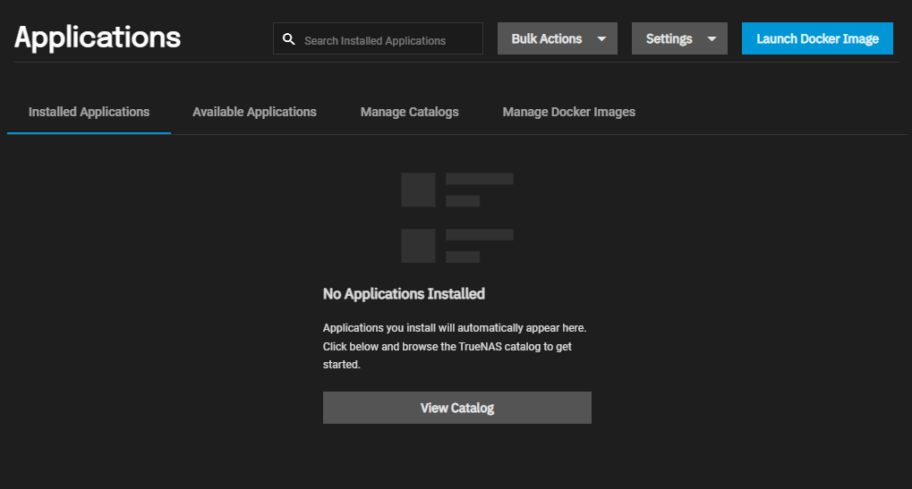

I am on the Truenas Scale release version (TrueNAS-SCALE-22.02.0).
Yesterday I rebooted my system and noticed that the apps disappeared:

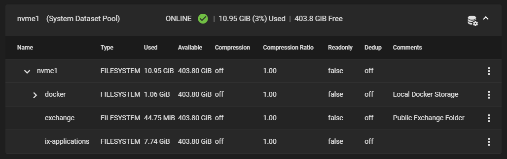

The pool is still there and data as well:
