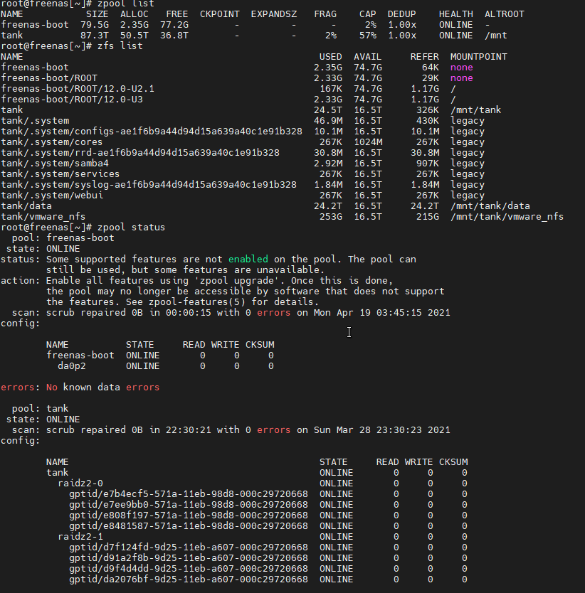

Hi there,
I know this is a recurring question, but I'd like to make sure I don't miss an option if I ever have one other than to backup and redo everything.
I had until now a pool of 4 disks 12Tb in Raiz2.
I decided to add 4 more 12Tb disks in the server. I created another Zpol Raiz2 with the 4 disks.
So I have just 10Tb more available. Not very efficient.
Logical, ok...
If I want to optimize my free space. Do I have any other choice than to start from scratch and create a Raiz2(or3) directly with the 8 disks ?
Thank you!

Unfortunately yes, as you know, you need to match the existing vdev when adding multiple. IMO RAIDz2 is currently the standard (for storage) per vDev at a max of 8 wide. Just consider future expansion and cost, for example, is purchasing another 8 disks for expansion unreasonable. Would another pool be a compromise, or would 6 wide be better.
Whatever you decide, I think you need to rebuild that pool, RAID2Zx4, isn't very efficient and again IMO 6 wide is nice for a small deployment. However I am running 5 wide in RAIDz2, it was due to cost and space requirements, but I would have preferred 6 wide.
On the question of other options, you can wait, expansion of vdevs have been in development for quite a while, I wouldn't have gone 5 wide if it wasn't for this. Check it out: https://github.com/openzfs/zfs/pull/8853
I don't think you're doing the addition correctly... you should have 20TB+ more storage available (OK, so you shouldn't use all of it, but clearly more than 10)
Hi
You are right! My bad
I was "comparing" with another mini server in RAIZ1; Not the same!
So yes, indeed it represents an addition of +20Tb. But it's true that for 4 DD of 12Tb that's not a lot ;-)
