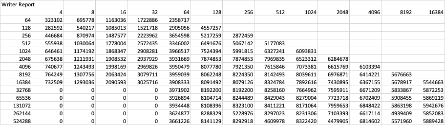

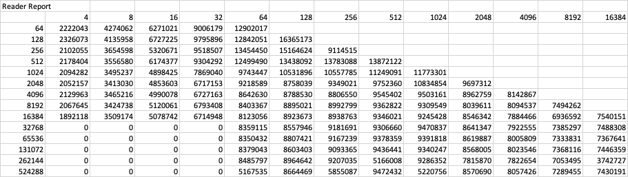

I tested with iozone and get those results :
Writer speeds :
Reader report :

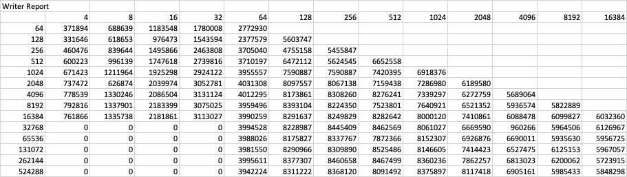

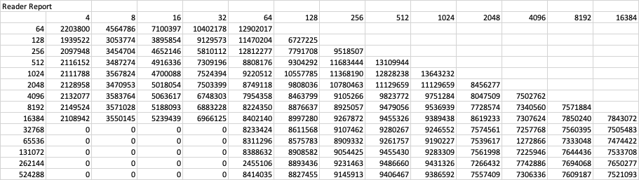

Ok something was wrong on my previous tests, I didn't disabled the compression and it seems that iozone tests with zeros so ... Benchmark was biased. I've created a Dataset for this and tested again. Checking IOStat I have those results :
And looking at FreeNAS reporting I have a 84MB/s per disk writing speed, which in my case of RAIDZ2 would be a usable 336MB/s ... Way above the gigabit I want to achieve.
