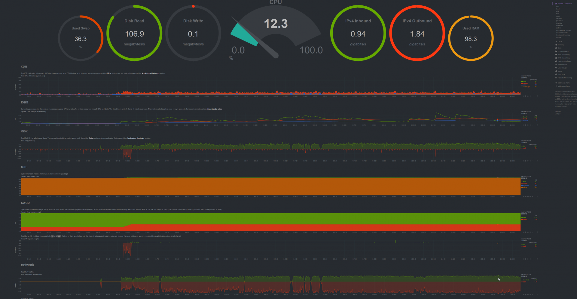

As I am writing this post, I decided to run some test in term of throughput from my Nextcloud iocage jail.
The schreenshot attached is a quick test I have been running while writing this post.
The screenshot shows throughput conducted from my Nexctloud jail synching into my Windows 10 2950x NVME drive.
in just 15 minutes later, I was able to sync well over 80GB of photos, quite impressive. It doesn't quite max out the LAN but can easily hit 940Mbit/. I must add, that my Nextcloud connection is being routed through my haproxy running on my pfsense.
Compared to my Xeon E3 and Pentium G4600, Threadripper is a beast.

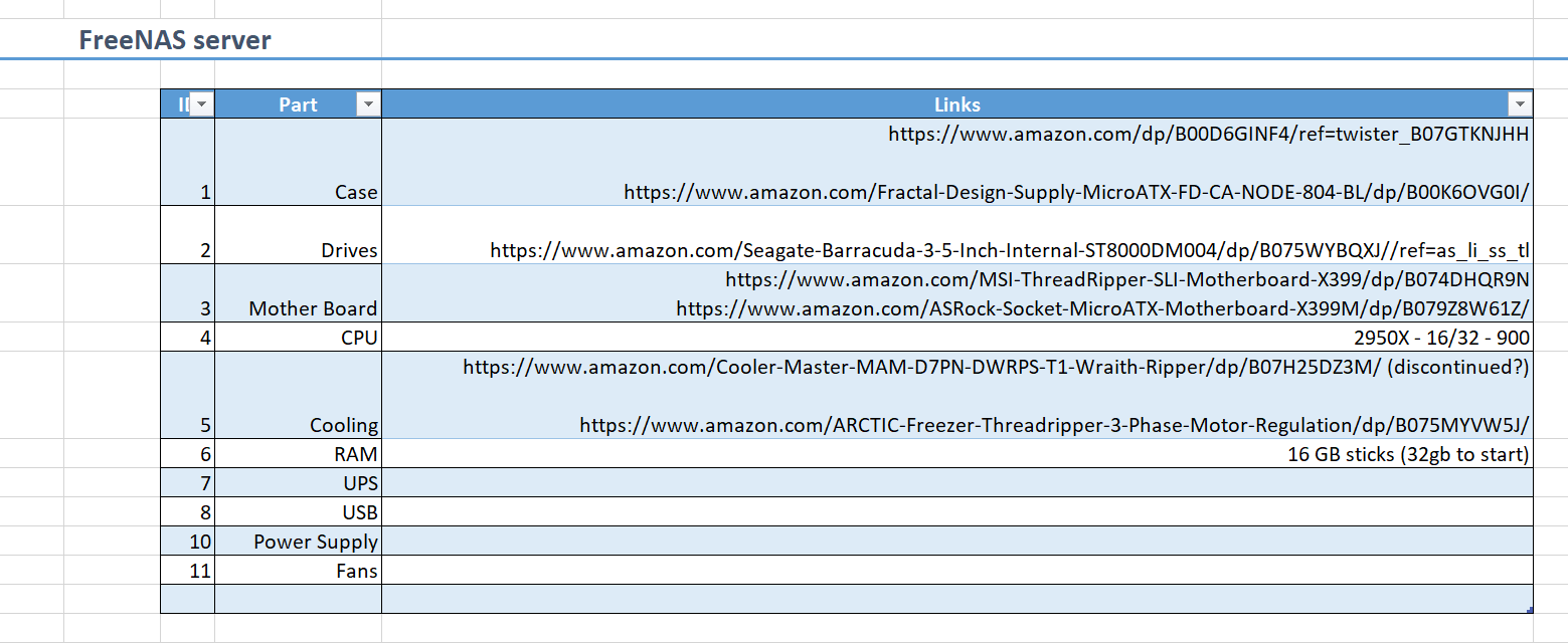

to add one more thing, I am collecting links etc and hoping for some blackfriday discounts... so I have some time before I purchase but... in regards to cooling what are you using?
I am relatively new to this sort of thing, should I be looking at liquid cooling? when I look at your system build I see no mention...also could you share the case you used?
My Threadripper is using the Freezer 33 TR from Artcic.
The case is a Rosewill RSV-L4412.
One issue I have is that the Freezer 33 TR is about 5mm or so too tall and the case will not close properly. Something to watch for.
The official Threadripper Wreath CPU heatsink wasn't available. A bad move from AMD and its partner.
The Freezer 33TR seems to be doing a fine job in general when not being pushed too hard. I had issues at the end of summer but I am not sure if it was due to Freenas 11.x bugs and instability.
If you go with water cooling, I would say to be cautious due to potential leaks that could occur over time.
I used to have a watercooled i7-920 before moving to the 2950X threadripper for my main home PC. I designed the loop myself and has been very solid for the past couple of years.
Currently my 2950X has the Cryorig A40, but my PC never stay on while I am away.
When I run 2950X on all cores and threads, the temperature will rise fairly quickly to the point it will start throttling down the CPU.
I think Cryorig A40 should be adequate to keep the 1900X cooler, has it has less cores. The Rosewill case will not accomodate the radiator so this will make it an unfit solution. I do like this hot swappable HDD tray. This is the reason I got the case in the first place, but the case is really long which is unfortunate.
Some other thought about Cryorig A40 is the extra fan for VRMs, while quite a nice addition, the engineer who designed it never thought about the cooling tubes as being an issue. Currently, they are running in front of the fan which is causing a drop in efficiency. They could have come up with a better solution instead. Also, the length of the cooling tubes can be of a concern depending on your case size and configuration as the tubes are not very long and do not provide much flexibility as a result.
One thing to know about AOI (All In One) watercooling is that they never seem to come with any kind of flow sensor, so you can't really tell if the loop is working. This was a major drawback when I first setup my 2950X Windows 10 PC. I had lots of issues back then because of the Bios.

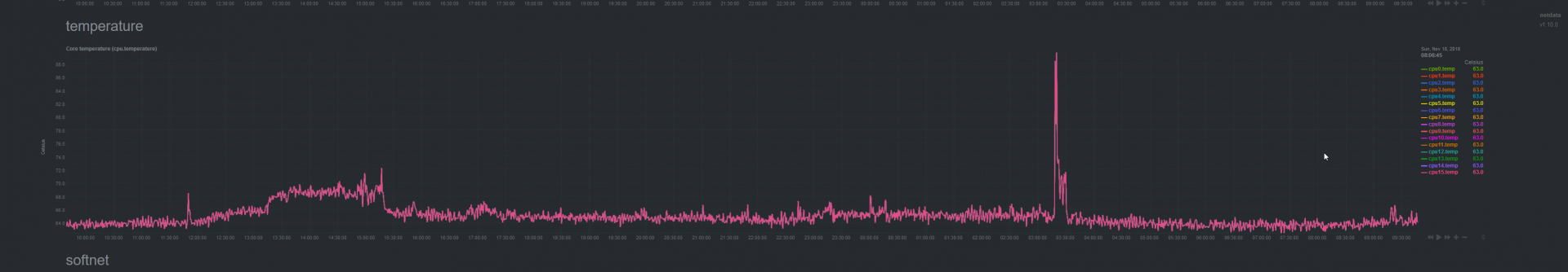

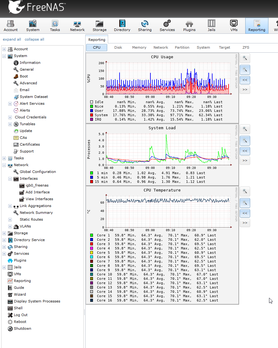

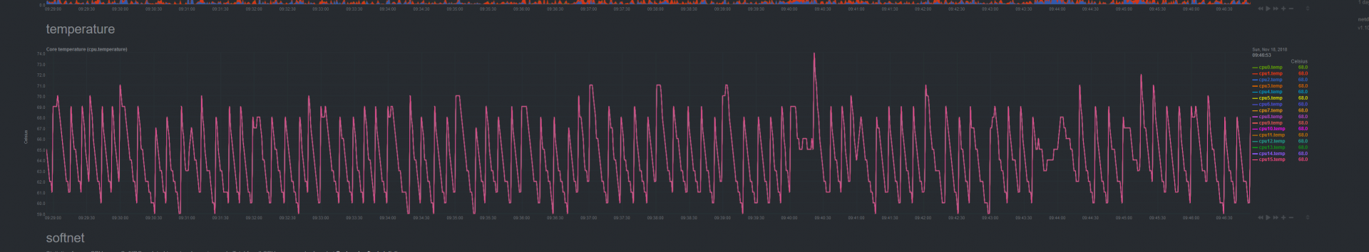

Any concerns on cpu cooling? Far as I know no Ryzen or newer AMD has temp sensors on freenas. This kind of worries me since my last freenas box ran for 4yrs straight and I'm on a new Ryzen 7 2700 with no temp monitoring.
Apollo
Jun 13, 2013
1,458
CPU temperature is available on Freenas-11-2-RC1 which I am currently on.
CPU temperature shows up in Netdata as well.
I am not sure which sensors are actually used, per core sensor or Die sensor.
But it would seem Legacy GUI and Netdata are using single core temperature sensor while Angular GUI is looking at the Motherboard temperature it seems(my own observation).
Only concern I have had with CPU was when running Plex to transcode several 1080p and 4K and was causing system to crash, but I don't know if it was temperature related or simply due to Freenas and iocage instability. At the time temperature would ramp-up, power consumption was at the highest around 290W.
On the bellow Sintel 4K screenshot, I just ran a few minutes ago, 5 instances of Sintel 4K in Firefox.
The original file is 4K @ 40.6Mbps.
On screenshots you can see transcoding at 84.2Mbps on 2 Firefox instances and 63.2 for the other 2. The last one I can't say.
At that time CPU what able to hit 100% usage and hit in the high 90 degrees C.
For this run, 1900x hasn't crashed and is on its 27th day without reboot.
Has it is, CPU cooler isn't bad on my typical daily run. However, stressing it like I did would be a huge concern over long period of time.
A beeffier cooler like the official Wreath from AMD would be a better fit I think.

Do you mind sharing your hardware wishlist?
newfreenas
Nov 7, 2018
30
my hardware wishlist is still in the making, but to be fair aside from AMD CPU, 16GB sticks of RAM (intend to get 64 to start) and at least 20TB I do not care what it looks like as long as its properly cooled and not extremely loud. I'm happy to take recommendations... I've read most of hardware reference guide and was slightly deterred because of lack of reference to AMD. I liked this chassis --> https://www.amazon.com/dp/B0091IZ1ZG/ but I also liked the cube chassis and I really do not need one that big. I have a lot of analysis paralysis... feel free to help! frankly I almost bought much of what you have until I saw you had an issue with the case closing... I know its a small thing to deal with... but buying new stuff I just want to account for things like that.
also planning to use next cloud... but only because I am familiar with it, and thoughts on owncloud?
I tried to get table formatting in this but I failed... I posted picture below of what the text below should look like.
ID Part Links
1 Case https://www.amazon.com/dp/B00D6GINF4/ref=twister_B07GTKNJHH
https://www.amazon.com/Fractal-Design-Supply-MicroATX-FD-CA-NODE-804-BL/dp/B00K6OVG0I/
2 Drives https://www.amazon.com/Seagate-Barracuda-3-5-Inch-Internal-ST8000DM004/dp/B075WYBQXJ//ref=as_li_ss_tl
3 Mother Board https://www.amazon.com/MSI-ThreadRipper-SLI-Motherboard-X399/dp/B074DHQR9N
https://www.amazon.com/ASRock-Socket-MicroATX-Motherboard-X399M/dp/B079Z8W61Z/
4 CPU 2950X - 16/32 - 900
5 Cooling https://www.amazon.com/Cooler-Master-MAM-D7PN-DWRPS-T1-Wraith-Ripper/dp/B07H25DZ3M/ (discontinued?)
https://www.amazon.com/ARCTIC-Freezer-Threadripper-3-Phase-Motor-Regulation/dp/B075MYVW5J/
6 RAM 16 GB sticks (32gb to start)
7 UPS
8 USB
10 Power Supply
11 Fans
