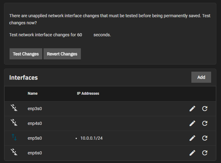

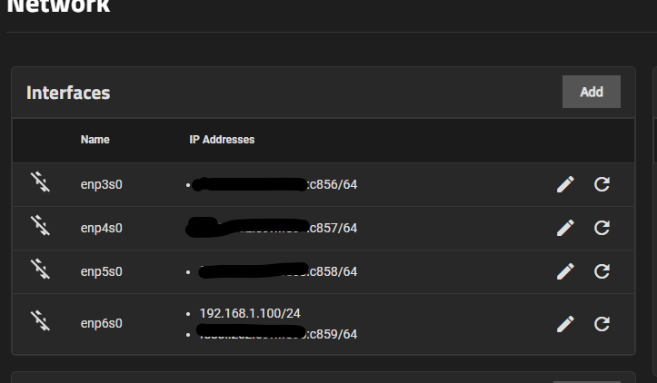

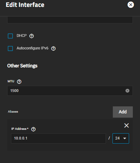

My NAS has 4 network interfaces. 2 are used with a VM, 1 is my main LAN interface, and the last one is open. I am trying to set up a direct connection between my homelab and my TrueNas using the last interface. (both are 2.5 Gbps, where as my switch is only 1 Gbps). When I go into the try set the static IP using https://www.truenas.com/docs/scale/scaletutorials/network/interfaces/settingupstaticips/ after I click save, but before clicking test it disables all my interfaces. This makes the test fail becuase the gui interface is disabled, but it isn't even the one I'm trying to change. I'm not sure how to work around this. I've tried it using a keyboard and monitor as well with the same results, so it must be something I'm missing right?
What is your homelab? A switch to your homelab? Another machine?
Does this machine / homelab also have a NIC configured on the 10.0.0.1 subnet?
Did you remove all IPV6 entries on the other interfaces during setup of the static IP?
As far as I know the test does neither fail nor succeed, it may just be that you lose your network connectivity. Do you mean that and it reverts back after 60s?

Some comments:
  • If your existing NIC is using DHCP, you CAN'T add another, (as far as I know). Change it to static first.
  • You can't have 2 IPs in the same sub-net. Make a new sub-net for the 2nd NIC's IP.

Some comments:
This may be helpful;
I had to disable DHCP and set a static IP (the same it already had) for my main interface first. I would not have guessed that. I already had a static IP on my router so I didn't think there would be an issue. Thank you!
