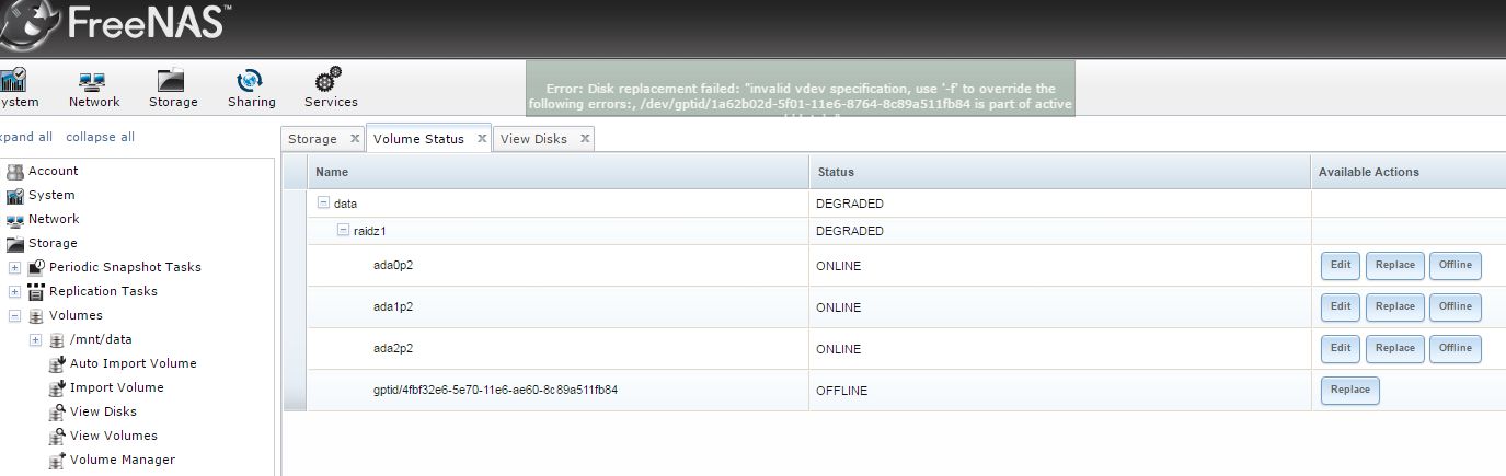

Hi all,

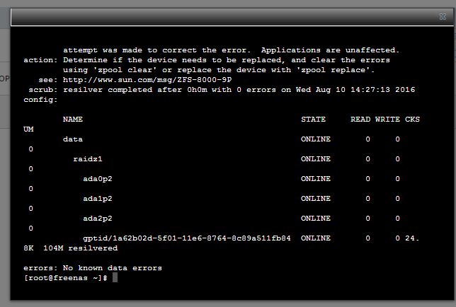

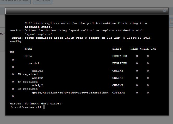

Some years ago I set it up for a client the FreeNAS 8.2 with 4 of 1TB Seagate HDD in raidz1. One of the HDD failed and I removed before set it to Offline for replacement, therefore I do not see it on the list in "Volume Status". The raidz1 is degraded. I installed new 1TB SSD and it appears as "OFFLINE" with the name as "gptid/4fb...84" (pic1). I'm planning to replace all 4 HDD, but first I need to fix the raidz1. The button "Replace" giving me an error "...invalid vdev specification, use '-f' to override..." I tried to do zpool online or replace in the shell, but I guess I do not exactly know what is "pool" and "dev" because whatever I used it gave me an error. The "Alert System " is telling me to use "zpool online or zpool replace". I was unsuccessful there... So, now I'm trying to extend the volume through "Volume Manager" (pic2), where I can set the ZFS Extra I guess as "Spare", but when I select the disk (pic3), the selection for ZFS Extra will disappear. Maybe a Bug...

(1) If I will click on "Add Volume" to extend existing "data" volume, will it add the disk correctly into my raidz1?
(2) I'm assuming that it will clear data only on the added new disk and not on whole "data" volume. Correct?
(3) If this isn't the way to do it, what are the correct steps?

The problem with using the Volume Manager is that it will not replace a drive; it will instead add the drive to the pool. You'll then have a (say) three-disk RAIDZ1 striped with a single disk, and if the latter fails, you'll lose all your data. I know that recent versions of FreeNAS have warnings to try to prevent this, but I'm not sure that 8.x does.

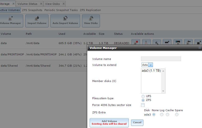

Here is the zpool status...

I'd try zpool online. <pool> is the name of your pool, which is "data". <device> is the device you want to online, which appears to be /dev/gptid/4fbf...
Edit: and if that works, try rebooting the system so that the GUI will follow what's happened.

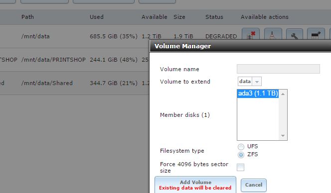

after reboot, status shows all ONLINE but log giving me some checksum mismatch (pic5) and warning says:
The volume data (ZFS) status is UNKNOWN: One or more devices has experienced an unrecoverable error. An attempt was made to correct the error. Applications are unaffected.Determine if the device needs to be replaced, and clear the errors using 'zpool clear' or replace the device with 'zpool replace'.
should I zpool clear?

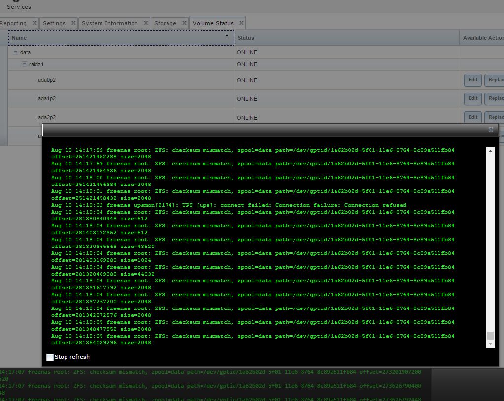

zpool clear didn't do anything and scrub didn't report anything either, but status is now saying:
scrub: resilver in progress for 0h0m, 0.50% done, 0h56m to go...
So, it sounds like it is on a good path now.

I'll let the resilvering finish.
I'm still getting the checksum mismatch messages, though. In shell's zpool status it keeps raising the CHKSUM # in K, but resilvering stays on 104M after few refreshes within past 20 minutes (pic6). Is that normal?
