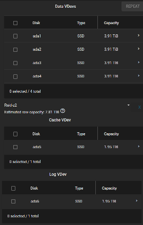

Hi, I'm planning to expand my pool from 4x4Tb to 4x12Tb disks in RAID-Z2. TrueNAS runs unders Proxmox, and this is the hardware specs for VM
  • RAM: 64GB
  • Main MoBo: Q370M D3H GSM PLUS
  • Using Onboard SATA controller (6 SATA ports)
Because I still have 2 more free SATA ports, I'm thinking to the possibility to add 2 more SSD drive (maybe 1TB each) to use as Cache and Log to increase performance.
I already know that I should use mirrored VDEV, but I prefer RAID-Z2 for its data security (supports up to 2 disks fail).
I read somewhat on the wiki page and around the web regarding ZFS Cache and Slog, but I think a street test will be the best. So I just created a TrueNAS VM and use Virtual Disks to emulate the main TrueNAS. Pool was built in the following way, so 4x4Tb disks in RAID-Z2 and another 2 disks one for cache and other for log:
I did just some test with and without cache/log, and this is the result:

So it seems only write speed is affected (log disk).
What do you think guys of this approach? Pros, Cons?
Thank you.

L2arc is just a read cache, so it won't speed up write operations, and a log is only usefull with sync writes, e.g. ISCSI or NFS. If you're using smb then a slog is of no use to you.

Hi, and thanks for reply. The test in first post has been done on TrueNAS CLI directly. And yes, my main nas use will be via samba (transfer file and/or media stream.
So increased speed in my test is useful only from cli, but not in my usecase right?
Davvo
Jul 12, 2022
3,222
Generally you want L2ARC and SLOG to be M.2 due to reduced latency.
1TB L2ARC is way too big for 64GB of ARC (you want a ratio of 1:4 or 1:6 ARC:L2ARC), and gigantic for a SLOG.
You want a SLOG if you enforce syncwrites (always).
You want a drive able to delivee good performance in mixed operations (concurrent reads and writes) for your SLOG.
You can easily check whether you need a L2ARC by monitoring the ARC's hit rate: if it goes below 90% it's worth considering it.

Something else of concern is if you are using the onboard SATA ports, how did you pass those disks through to the TrueNAS VM?
