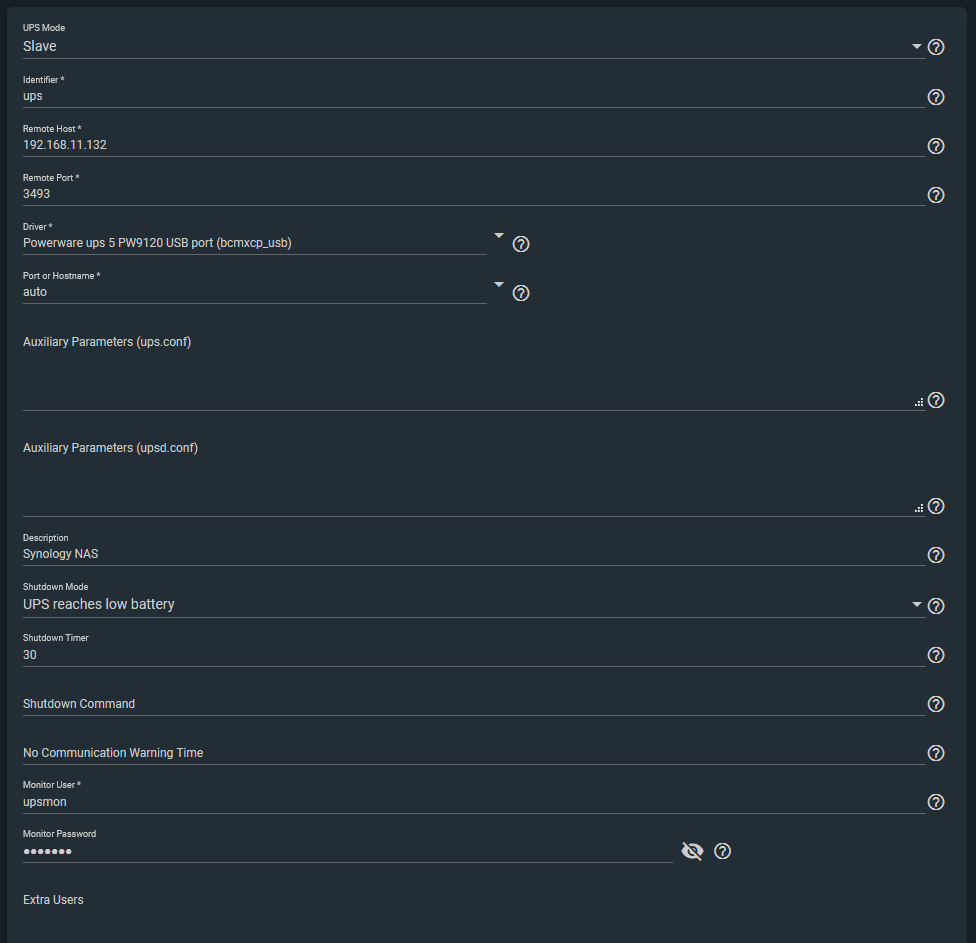

I have the same issue here: Truenas upsc get a list of my ups but it I start the UPS in slave mode Truenas console I get err message:
Nov 25 22:18:03 truenas 1 2021-11-25T22:18:03.803203-05:00 truenas.local upsmon 35555 - - Login on UPS [ups@10.240.0.20:3493] failed - got [ERR ACCESS-DENIED]
I tried to connect my OpnSense fw to my synology ups server and it fails too.
HELP !
