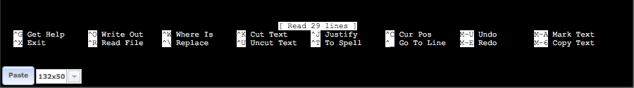

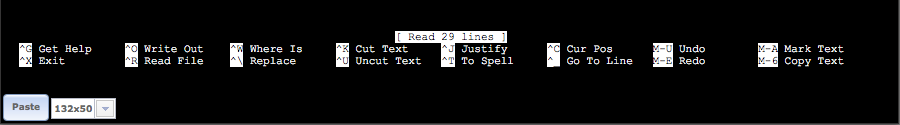

ctrl W (for write) I believe it shows at the bottom of the nano screen the different commands
This is all the options i get.
Redcoat
Feb 18, 2014
2,922
Ctl X for Exit, then Y to save - it'll prompt you for the save and the correct file name

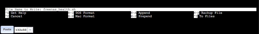

I did ^O and now I get these options.
15,504
See in the white bar where it's asking for the file name to write, and the correct file name is filled in? Press Enter.
zemun2
Mar 15, 2017
72
That worked. For some reason I thought I needed to select one of the options on the bottom.
