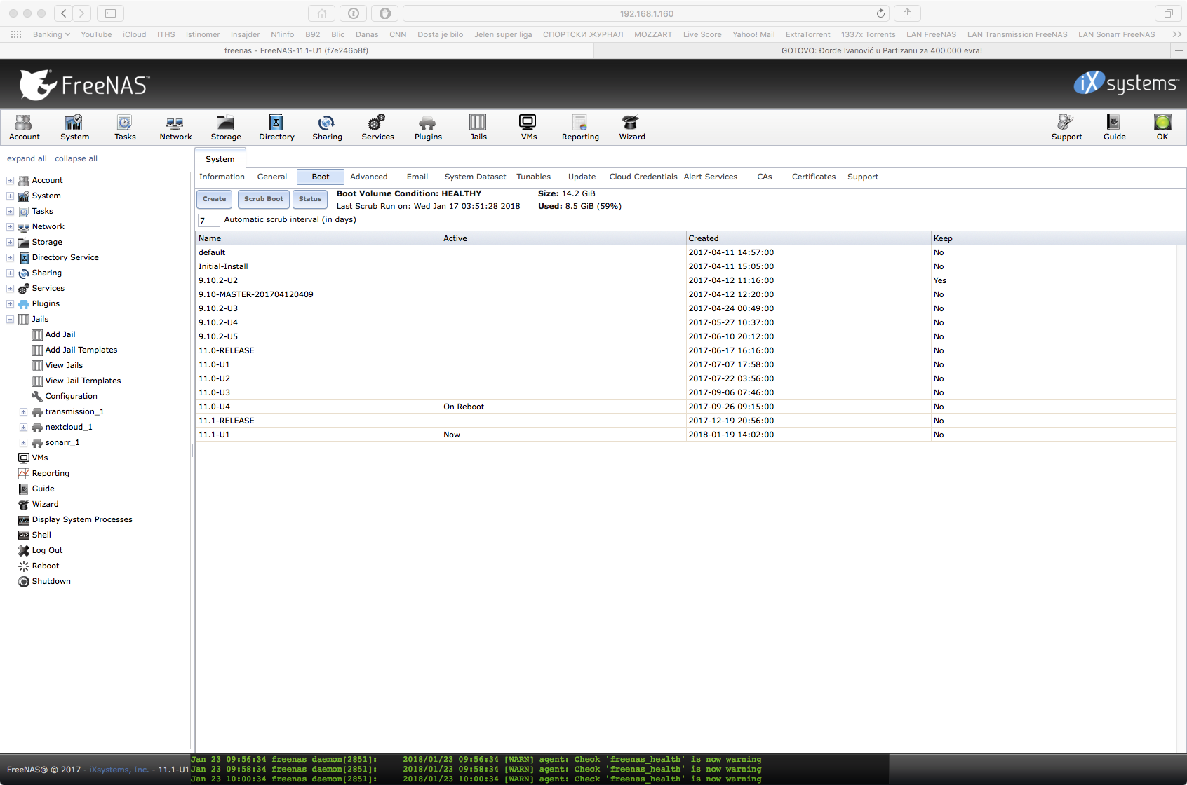

How do I roll back?
Thanks
Redcoat
Feb 18, 2014
2,925
Reboot and you will go back to 11.0-U4
zemun2
Mar 15, 2017
72
Rebooted 3 times already and no luck. Thought i was missing a step.

Step two: (not needed if you haven’t edited usr/local/etc/consul.d/freenas.json)
cd /usr/local/etc/consul.d
nano freenas.json
I changed the the interval back to 120s.
"interval": "120s"
Step three:
Executed the following in shell:
service consul stop
rm -rf /var/db/system/consul
service consul start
picklefish
Mar 13, 2016
62
Thanks @Mamdoh I will try this in an hour, appreciate the fix.
Edit: Seems like the only thing missing were the lines
  if [ -z $line ] ; then
   continue
  fi
Gone for now, thanks
