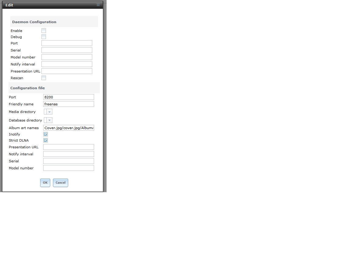

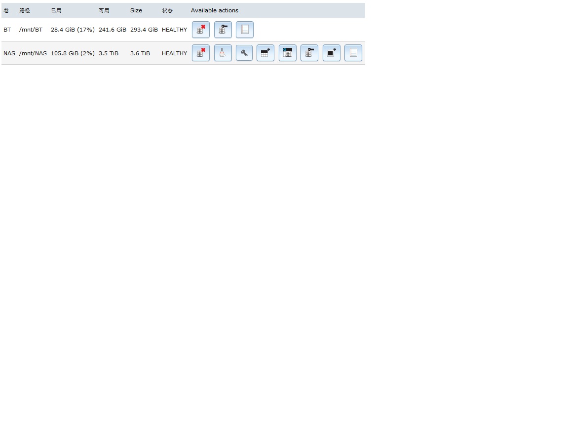

Below is my storage info.
After installing MiniDLNA, I click the edit buttion of dlna, it shows below info
The DB and MEdia directory drop-down menu shows nothing, and when click start, it will stay at starting DLNA server forever, but the server will not start.

It won't start if the Enable button is not checked. Regarding the greyed-out drop-down menus, this may be a bug related to creating a mount point to hold the data. That should get sorted in another day or so.

Media directoriy and database directory comboboxes are empty.
