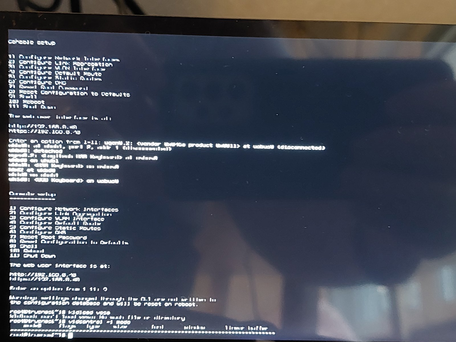

Hey guys,
I bought this little guy to get easier access to my boot menu since attaching a monitor every time was bothering me.
Unfortunately on that small screen I can't see the text properly. Do you have any idea how to change the resolution?

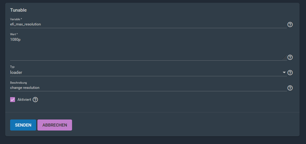

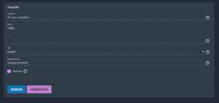

This might be helpful:
Look for efi_max_resolution. Then create a tunable of type LOADER in the TrueNAS UI.

Something like vidcontrol -f 16x32 /usr/share/vt/fonts/vgarom-16x32.fnt ..?
That did the trick. Thank you so much :)

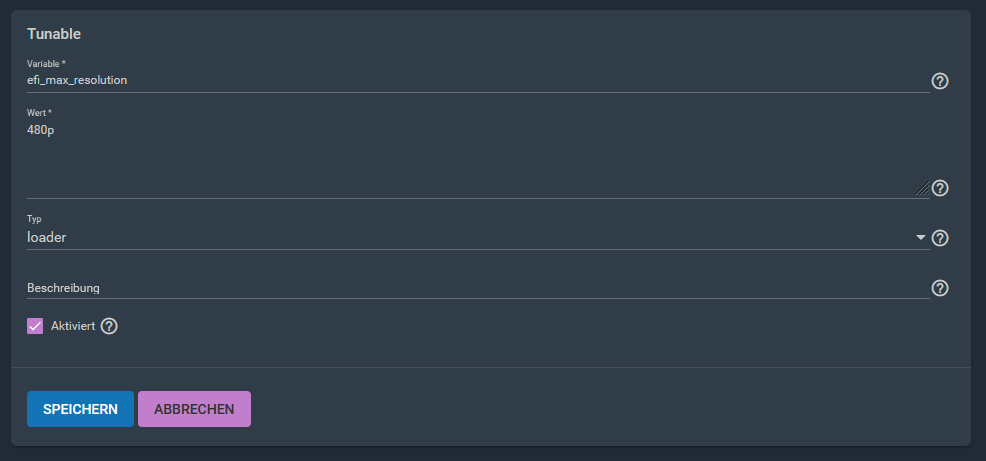

Since 800 x 600 is Super VGA you may have more luck (in the future) with that:
cheaptrick666
Feb 9, 2022
67
jgreco
Resident Grinch
May 29, 2011
18,680
While that solves your problem immediately, it's not persistent across a reboot. I'd try the tunable, too. The data sheet of your display should tell you the native resolution.
You can make it persistent across a reboot with a startup task. I didn't have any physical hardware that was sufficiently braindamaged to try this on so it was just kind of a random guess, if nothing else it is getting your toes wet in the craptacular world of VT font fun. I am probably angst filled on this topic as I see an 80x24 DEC VT100 as a fairly reasonable display and I really hate the 120 column 48 row thing VT seems to default to. The closest I was able to come to a fix for our installer was to stick efi_max_resolution="480p" into /boot/loader.conf.local (on a standard FreeBSD system), which could also be done with a loader tunable on CORE. That ends up with an 80x30 display at a reasonable resolution for those of us who work extensively with virtual consoles and would prefer something sized sort of like the old syscons 80x25. The problem is that it really depends on the physical hardware when you're actually sending a signal out to an LCD panel, and that seems more finicky when I was experimenting with it on hardware.
