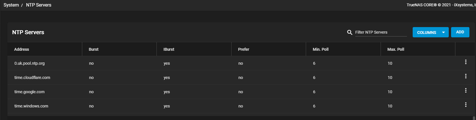

I have set up NTP with the following:
I welcome any advise of there are better NTP servers to use

Good that you fixed your problem @Fred974.
As for NTP, all of your references are pretty generic or global... Google, Cloudflare, ...
NTP is sensitive to latency and for that reason, better for you to take references that will be closer to you. The French government may have some public time references. Local universities and others may also have some.
Your actual config and reference will be up to the task, but as you asked if there is even better, actually there is.
