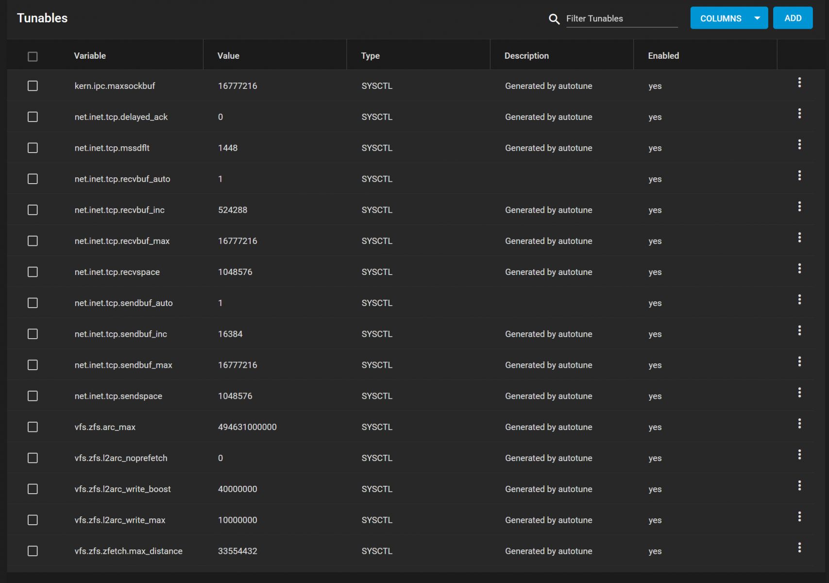

Also here's my current Tunables:

I solved the problem, it needed jumbo frames, in both end interfaces (sender + receiver/TrueNAS) AND in the switch
Kris Moore
SVP of Engineering
Administrator
Nov 12, 2015
1,471
Good find, this is common in a lot of these initial performance setups, people forget to set JF all the time :)
