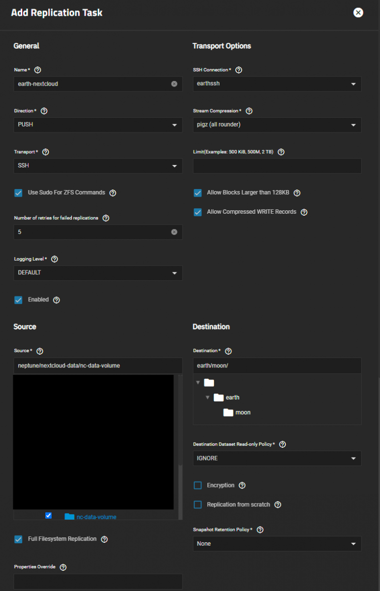

I setup a second server with some new hardware and some hardware I had laying around as a target for my replication tasks. I followed this post in order to setup the SSH connection.
First question here would be: I was not prompted for my root password yet. From what I gathered Use Sudo for ZFS Commands should be checked if I have not setup passwordless sudo. I did not change the configuration to the default core root user yet. Is this correct?
Second question:
This is on the source machine, neptune is the source pool and earth is the remote target pool.

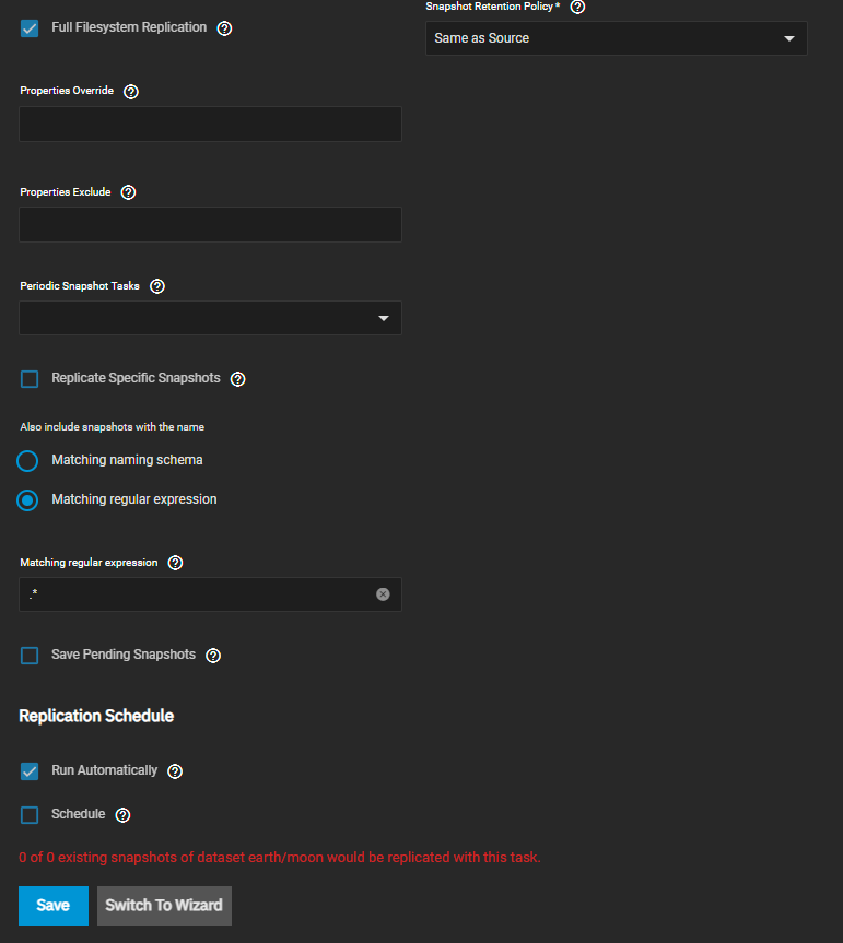

The last part in red confuses me: no snapshops of earth/moon would be replicated. But I do not want to replicate from there, I want to replicate to there. If I change the direction to pull, the message disappears.
Also, is there any advantage using the advanced options over the wizard? I just want to create a 1:1 copy of my main system.

1) The red warning message, which seems to indicate a reversed direction persisted
2) I wasn't able to successfully replicate until I added newpool/exisitingdatasetname manually in the destination field. I will still receive the message that an error occured because the dataset does not exist, but the replication task will then continue normally. The source datasets are encrypted.

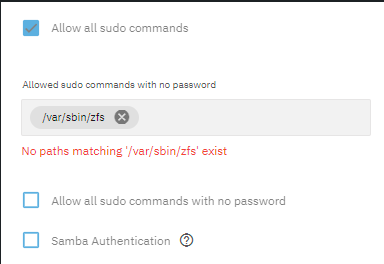

When trying to allow pwless sudo for /var/sbin/zfs I receive an error:
I'd like to avoid allowing all sudo commands with no password if possible.
