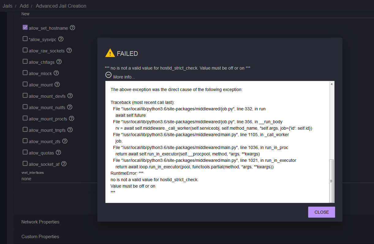

I just upgraded a freshly installed 11.2-U2.1 installation to 11.2-U3. I'm now running into the issue that I cannot install plugins or create jails, as I get the following error message. It seems there is an issue with the on/off vs. yes/no boolean options here.
sudo iocage create -r 11.2-RELEASE -n myjail boot=on
works fine.
Should this be reported as a bug? Or is something wrong with my install?

Can't reproduce your error on an upgraded test system:

I think I wasn't entirely clear in my post. The iocage command works for me as well - so I can create jails from the command line. Creating jails or installing plugins from the GUI gives the error message on hostid_strict_check.

What settings have you used? With the default dhcp + vnet, I can create both a plugin (e.g. transmission) and a jail via WebUI without error. Creating a jail via CLI produces expected entry in GUI which seems to function OK.

After re-reading your 1st post, did you have any jails running on 11.2-U2.1 before upgrading? In my test setup there were pre-existing jails before upgrading from 11.2-U2.1 to U3 and they are all still functional. Did you clear your browser cache after upgrading and before logging into the webui?

I can confirm this issue; When you create a jail from the "Advanced Jail Creation" tab, it fails with an error: *** no is not a valid value for hostid_strict_check. Value must be off or on ***
Creating a jail from the command line and through the regular wizard work fine.
This was reported for one of the nightly releases: https://redmine.ixsystems.com/issues/70993?issue_count=29&issue_position=1&next_issue_id=59688

Needs reporting if it's not already under FN11.2-U4 issues.

<<<I also have said problem. :(
Is the fix planed to be included with the new update? Any one have a work around using the GUI?
I can Install plugins no problem, but when I go to make a Custom Jail It does this.

11.2-U4 Fix's this Problem at lest for me.
