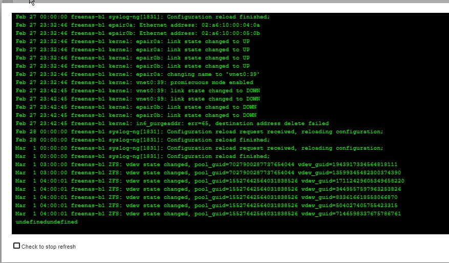

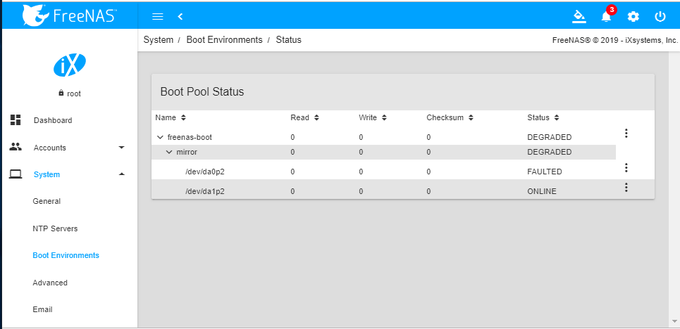

FYI: I then checked that my boot environment was still 11.2-U2 and rebooted in case the attempted update left behind some residual stuff. After the reboot, I ended up with a degraded boot pool. Easy enough to fix. Thank goodness for mirrored boot devices! Btw, my boot devices are USB sticks.

Strange. I repeated the update today and it now takes. A hiccup somewhere. What seems to be happening though is that I have had to repair the boot devices on the two servers I updated.
