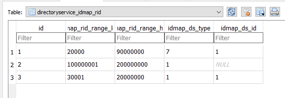

While I'm sure it's very useful to remember old configurations, unfortunately that feature looks to be causing an upgrade problem. Even if you remove all your samba shares AND leave the domain the upgrade will fail (or at least it does for me). If I take a backup of my 11.2U8 config and browse the backup I can see the "old" and "invalid" rid entries that are causing the upgrade to fail even tho I no longer HAVE and active samba config ..
Entry #1 and #3 are configs I believe are invalid now in 11.3x and will cause Samba to barf, while #2 is what 11.3 defaults to for the rid backend on 11.3 for me.
I highly expect this leftover cruft is the issue, unfortunately I have no idea how to clear it out of a running system. However in a very very limited test, I edited out #1 and #3 above (switching the ID of 2 to 1 as well) of a backup of an 11.2U8 System, restored the backup (now minus that cruft) and then updated to 11.3 .. The upgrade at least succeeded :)
However as it was just a quick thrown together VM, the config could not be tested with all the things I normally use my real physical NAS for... But at least as far as the 11.2U8 to 11.3U2 upgrade is concerned .. It worked.
So my next step is to update my running config to the new RID values, and update every single ACL (sucks).. Then take a backup while on 11.2U8, remove the offending cruft, restore BACK to 11.2U8 and THEN try the 11.3U2 upgrade again...
What a PITA. If there is a way to clear this cruft out of the running system that would make things quite a bit easier ..

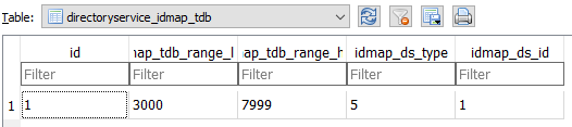

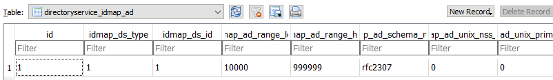

My FreeNAS is joined to a samba ad domain and I do not make use of the rid id backend at all and never did. So why should rid play a role at all?
The smb.conf here says
idmap config *: backend = tdb
idmap config *: range = 3000-7999
idmap config MYDOMAIN: backend = ad
idmap config MYDOMAIN: range = 10000-999999
idmap config MYDOMAIN: schema mode = rfc2307
idmap config MYDOMAIN: unix_primary_group = no
idmap config MYDOMAIN: unix_nss_info = no
idmap config MYDOMAIN: unix_primary_group = yes
idmap config MYDOMAIN:unix_nss_info = yes
The duplicates are the result by me setting the last two lines via the GUI. Not nice but they work.
The DB correctly reflects the id ranges:
The rid ranges must be some built-in default - I never used it -, and it indeed overlaps with the above, so NAS-102169 could be true.

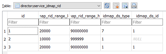

Next I'll try to move rid settings out of the way (only number-wise, no more overlapping with tdb and ad and maybe others) and look if that will improve things.

I deleted records 2 and 3 from directoryservice_idmap_rid above and restored the so patched configuration via the FreeNAS GUI. Then the update went through, to version FreeNAS-11.3-U3.2 this time.
AD membership got lost during the update, and rejoining did not work right away: The update procedure had converted my site's trusted CA certificate into an own certificate with a missing private key. I had to delete that from the configuration and then I was able to join my domain again.
One extra reboot required to get SMB shares and winbind operational.
Finally it looks like everything works again.
Thanks rv for the hint about the idmap rid ranges.
