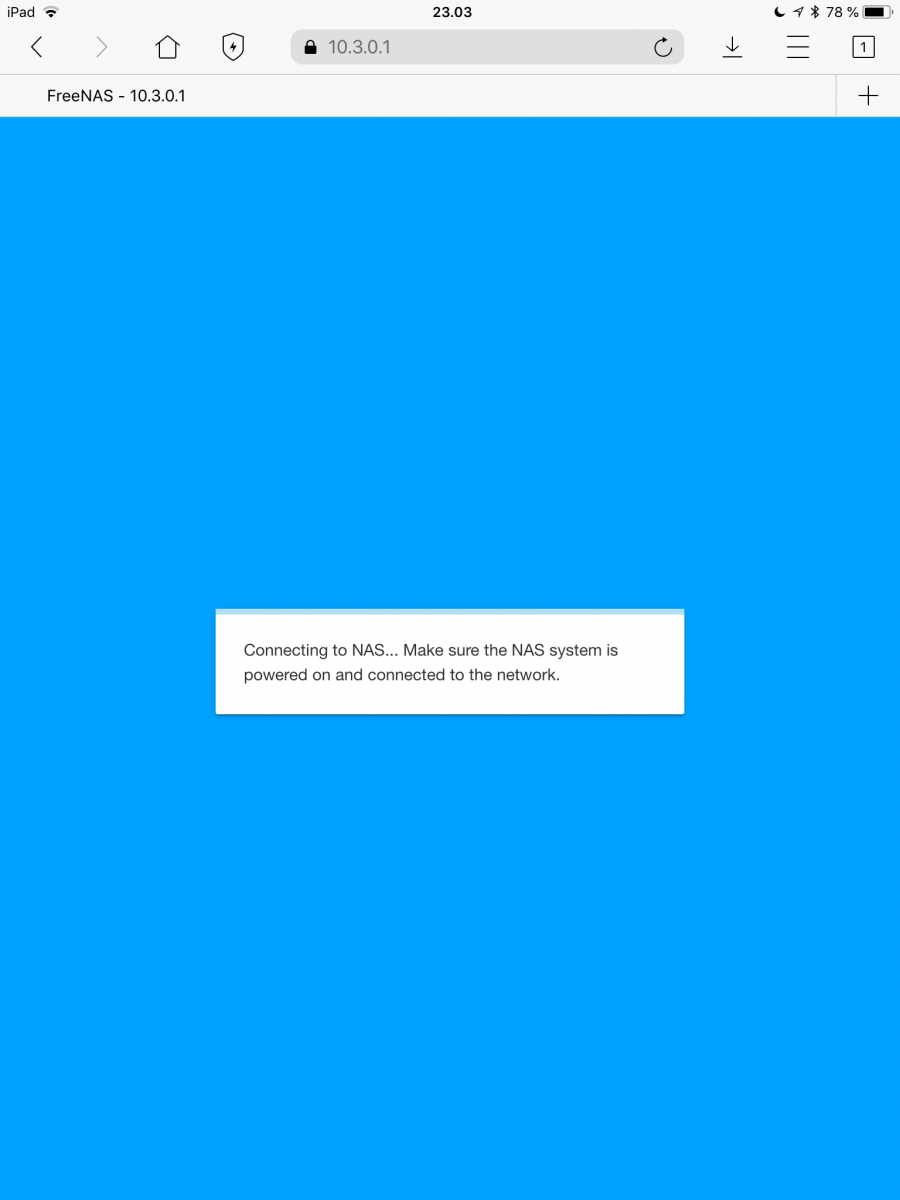

Same issue with 11.2-BETA2 - on iOS (Firefox, Chrome, Opera, Safari, Aloha), but using the same browsers on my Mac works fine. Spooky!
