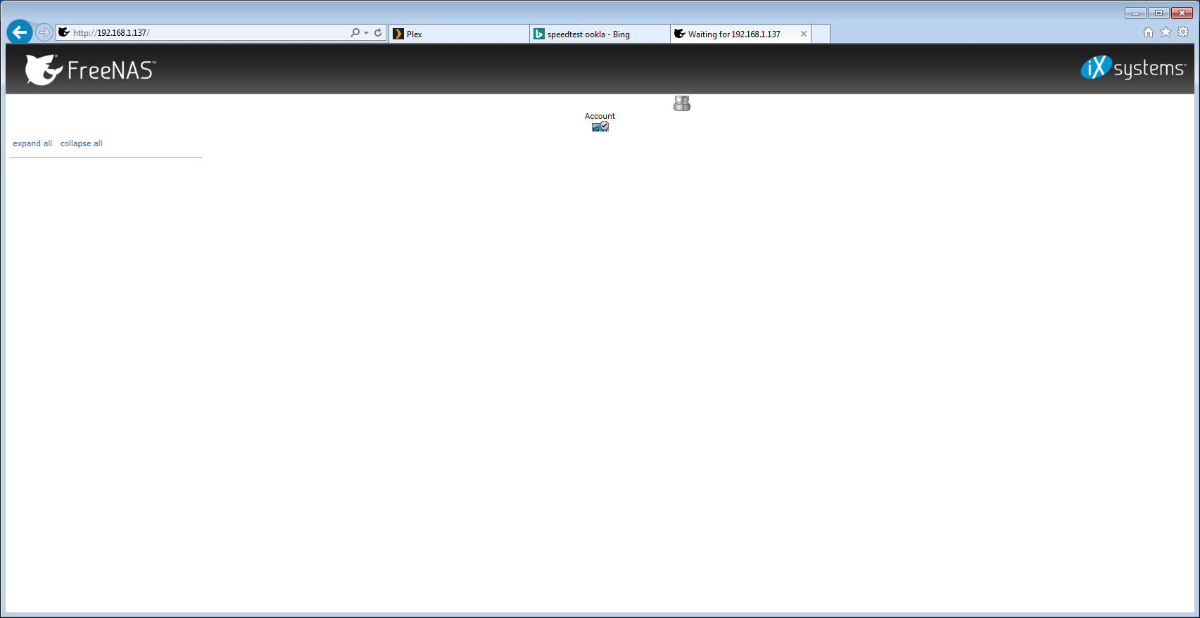

Here is what I get...I can't catch a break with this Freenas...LOL. I don't even know what to do about this...

No that's it. It does not do anything other than that. I guess I can try a reboot although it did when I applied the updates.

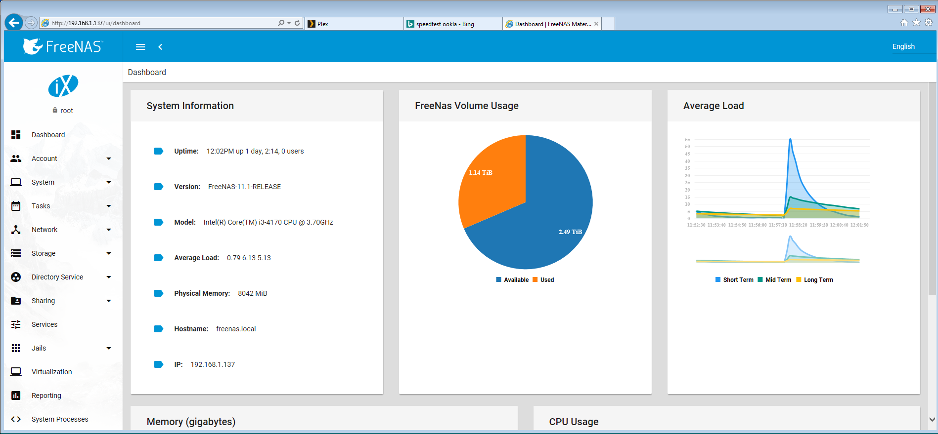

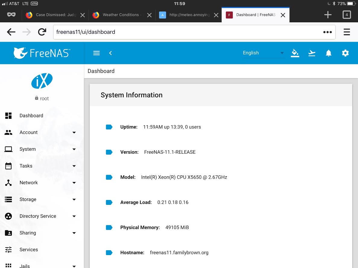

There were issues reported with 11.0-U4 where the GUI wouldn't load completely, but they were supposed to be fixed in 11.1. But what you're seeing there is the old GUI, even if it's only partially loading. The new GUI looks like this:

I'm still on the 11.0 U4 version and when Chrome does not fully load, try hitting Ctrl +f5. This forces the re-load of the page in most cases.

OK that did it! Seems ok now. I don't really care for the new UI. I'm glad I can still use this one.

I-Tech
Aug 14, 2015
36
also had this in IE 11 Win8.1 (don't ask...) and no matter what i did.. clear cache / refresh / restart / etc.. didn't change.
used Chrome and got old UI without any problems.
edit: /ui/dashboard gives me the new ui in both... (cannot seem to find Tasks/CloudSyncs in the new UI.. but that's another story)
