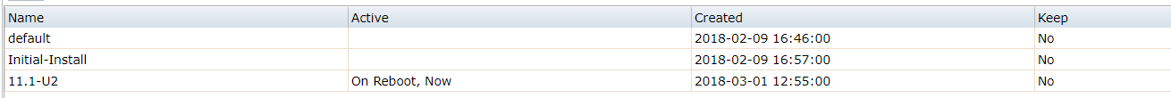

Have you made changes in CLI to a native FreeNAS file (I do not mean added a script but eg. edit /etc/rc.conf)? Run verify install in the update section. Then update again (when the boot environmentss are deleted).
I had a checksum mismatch of a file which was blocking the update.
finsfree
Jan 7, 2015
46
After reading this thread I was able to resolve my issue with 11.1 U2.
I reverted back to the default then deleted the 11.1 U2. Ran the update again then booted to the new update 11.1 U2.
Worked perfectly! Thanks.

What was your default?
Sent from my ONEPLUS A3000 using Tapatalk
finsfree
Jan 7, 2015
46
It was labeled "default". I am kind of new to FreeNAS.
