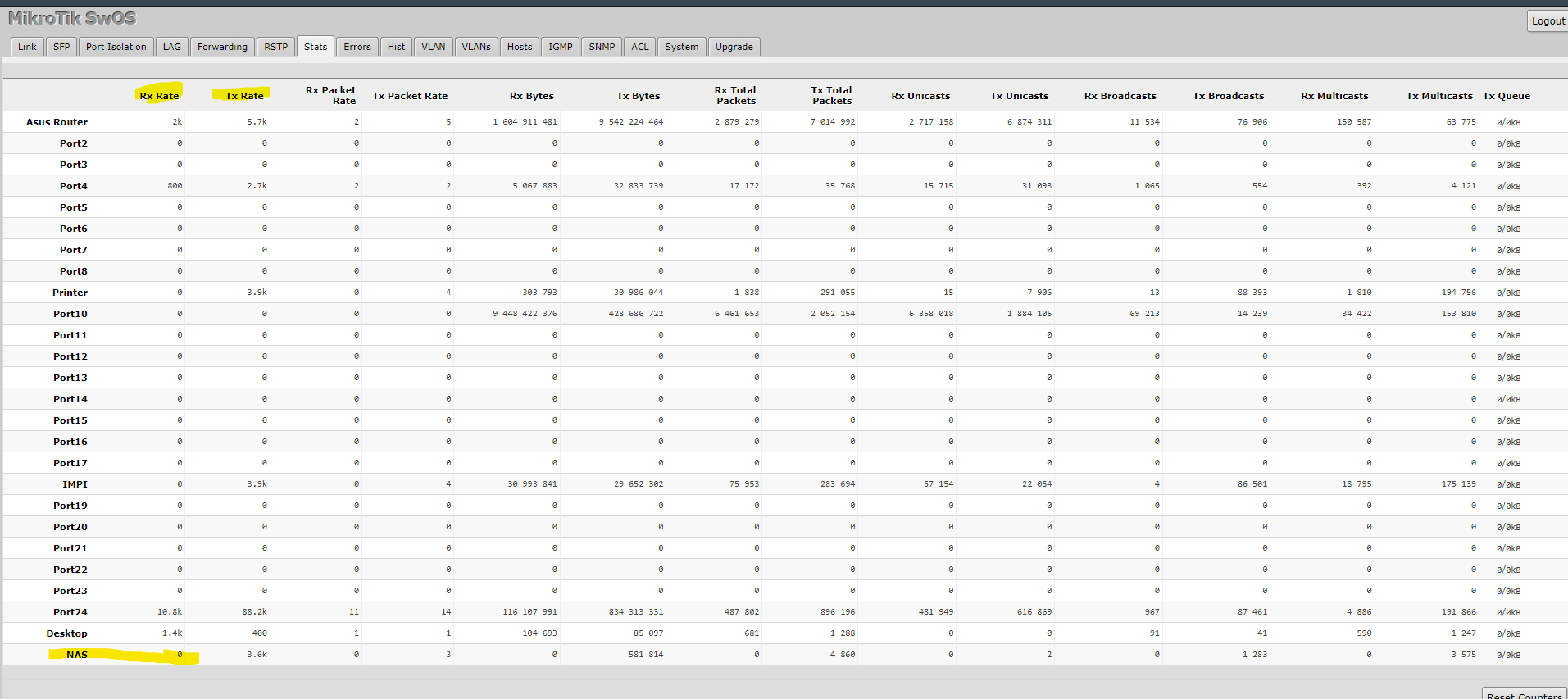

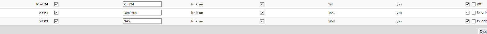

My switch shows me that the uplink is there (Mikrotik CRS326):
If i swap the leads of the fiber, no lights blink, and 'no link' is displayed, so i'm confident that's not it.
However, my stats page suggests the NAS side isn't transmitting anything:

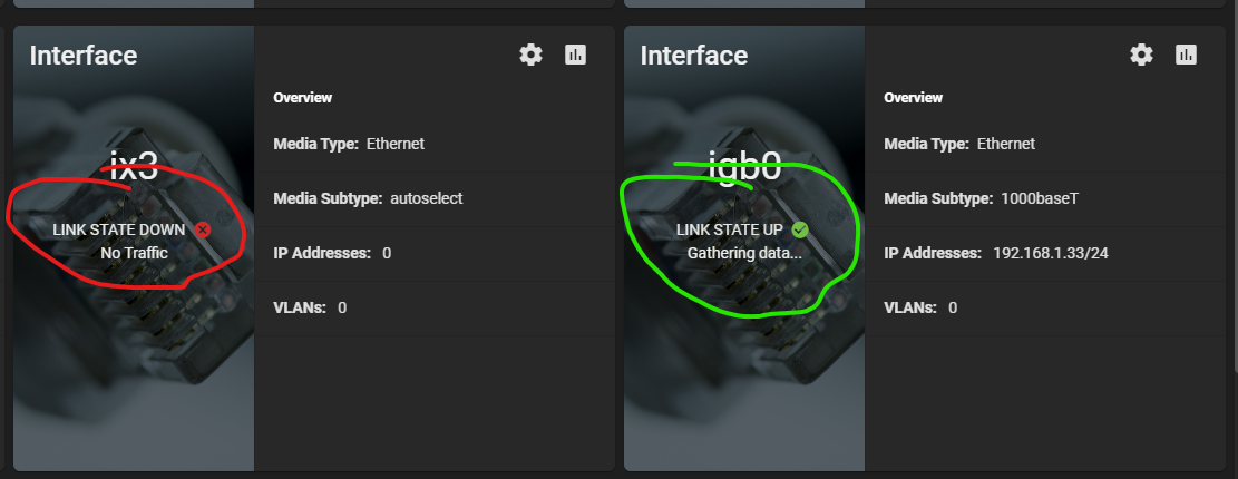

Normally, in Truenas, 'link state' should be up even if there is no IP, if i'm correct?
But i thought, that should maybe be normal becaus no IP is set?

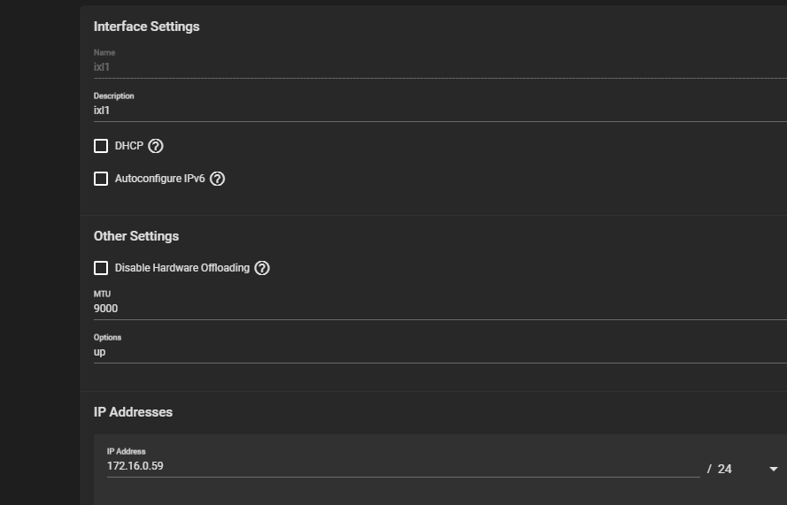

So i went and deleted the IP form the Gbe interface, applied and copied over on the IX3's interface page. (also tried all other IX interfaces..)
Hit apply changes and test for 60s, but no success.

When you try jgreco hint check if the NIC is UP because from your previous ifconfig list only ix2 is UP and RUNNING:
ix0: flags=8822<BROADCAST,SIMPLEX,MULTICAST>
ix1: flags=8822<BROADCAST,SIMPLEX,MULTICAST>
ix2: flags=8863<UP,BROADCAST,RUNNING,SIMPLEX,MULTICAST>
ix3: flags=8c22<BROADCAST,OACTIVE,SIMPLEX,MULTICAST>
If the NIC is not UP and you plug the cable there is no link.
To be easy to detect ix0, ix1... and physical ports bring UP all "ix" interfaces from console and plug the cable.
ifconfig ix0 up
ifconfig ix3 up
And to check if the SFP module is recognize you can use:
ifconfig -v ix0
Should have something like this:
plugged: SFP/SFP+/SFP28 10G Base-SR (LC)
vendor: FS PN: SFP-10GSR-85 SN: G1906102586 DATE: 2019-06-09
module temperature: 24.00 C Voltage: 3.29 Volts
RX: 0.00 mW (-40.00 dBm) TX: 0.0 mW (-40.00 dBm)
Thank you for the suggestion sir!
Will give it a try ;)

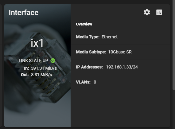

I tried indeed, et voila!
root@truenas[~]# ifconfig -v ix1
ix1: flags=8863<UP,BROADCAST,RUNNING,SIMPLEX,MULTICAST> metric 0 mtu 1500
        options=4e53fbb<RXCSUM,TXCSUM,VLAN_MTU,VLAN_HWTAGGING,JUMBO_MTU,VLAN_HWCSUM,TSO4,TSO6,LRO,WOL_UCAST,WOL_MCAST,WOL_MAGIC,VLAN_HWFILTER,VLAN_HWTSO,RXCSUM_IPV6,TXCSUM_IPV6,NOMAP>
        ether 6c:b3:11:0a:24:e2
        inet 192.168.1.33 netmask 0xffffff00 broadcast 192.168.1.255
        media: Ethernet autoselect (10Gbase-SR <full-duplex,rxpause,txpause>)
        status: active
        vendor: Uptimed PN: UP-TR-SR-CI SN: UPC22SR080033 DATE: 2022-03-04
        module temperature: 33.71 C voltage: 3.33 Volts
        lane 1: RX power: 0.61 mW (-2.14 dBm) TX bias: 6.34 mA
and:
Thanks a million!! @nKk
+ found out that you have to use the "ifconfig (enter interface) up" every time you swap sfp modules. And if I didn't dreamt it.. even when only messing with the modules on the switch side :oops:
But anywayz, things up and running, filecopy at +/-400Mib/s so i'm good :cool:
