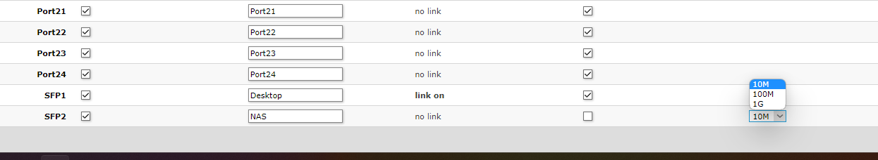

I have similar problem with Mikrotik SFP switch - the link is not established independent of modules that I try on the switch.
I found that if I manually select network speed (not use auto negotiation) - for example 1GB in Mikrotik switch, the link is established and working without other issues.
If you have time for tests you can try to set manually 10GB for NAS SFP port on Mikrotik switch and try again different SFP modules combinations.
I can select the speeds when i use the working combo, but if i insert any other module, the dropdown dissapears and i can't de-select auto negotiation.
Will investigate further tonight, did a quick check now during lunch break :wink:
Are you running RouterOS or SwitchOS?
(SwitchOS here)

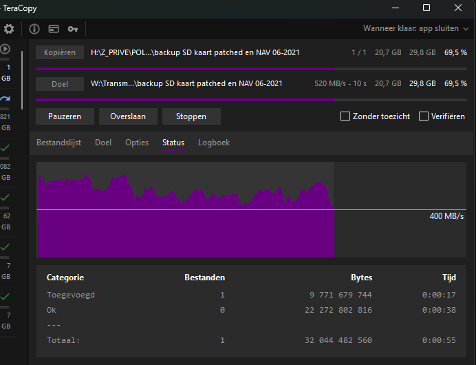

I did test the speed, and a question rose:
When copying data from a 980pro Samsung SSD on my desktop, i get these results:

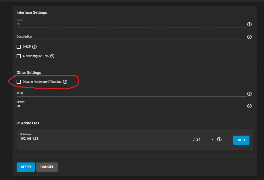

Could that be fixed with the 'offload hardware' tick in the settings on the NIC interface?
Or should i too, beware... :smile:
9,700
Have you run iperf across that same path?
Measuring multiple factors including SMB in the chain may not be helpful in determining if the problem is with the NIC.
(SwitchOS here)
If I remember correctly it was SwitchOS.
Currently I don't have access to the Mikrotik and can't check.

Performance seems inconsistent to me.
Enabled the 'disable HW offloading' tick under interfaces, following result:
Connecting to host 192.168.1.33, port 5201
[  4] local 192.168.1.86 port 51216 connected to 192.168.1.33 port 5201
[ ID] Interval           Transfer     Bandwidth
[  4]   0.00-1.00   sec   739 MBytes  6.20 Gbits/sec
[  4]   1.00-2.00   sec   740 MBytes  6.21 Gbits/sec
[  4]   2.00-3.00   sec   750 MBytes  6.29 Gbits/sec
[  4]   3.00-4.00   sec   753 MBytes  6.32 Gbits/sec
[  4]   4.00-5.00   sec   752 MBytes  6.31 Gbits/sec
[  4]   5.00-6.00   sec   744 MBytes  6.24 Gbits/sec
[  4]   6.00-7.00   sec   743 MBytes  6.23 Gbits/sec
[  4]   7.00-8.00   sec   745 MBytes  6.25 Gbits/sec
[  4]   8.00-9.00   sec   752 MBytes  6.30 Gbits/sec
[  4]   9.00-10.00  sec   751 MBytes  6.30 Gbits/sec
[  4]   0.00-10.00  sec  7.29 GBytes  6.26 Gbits/sec                  sender
[  4]   0.00-10.00  sec  7.29 GBytes  6.26 Gbits/sec                  receiver
iperf Done.
[  4] local 192.168.1.86 port 51252 connected to 192.168.1.33 port 5201
[  4]   0.00-1.01   sec   351 MBytes  2.93 Gbits/sec
[  4]   1.01-2.00   sec   711 MBytes  6.00 Gbits/sec
[  4]   2.00-3.00   sec   698 MBytes  5.86 Gbits/sec
[  4]   3.00-4.00   sec   713 MBytes  5.98 Gbits/sec
[  4]   4.00-5.00   sec   700 MBytes  5.87 Gbits/sec
[  4]   5.00-6.00   sec   706 MBytes  5.92 Gbits/sec
[  4]   6.00-7.00   sec   704 MBytes  5.91 Gbits/sec
[  4]   7.00-8.00   sec   716 MBytes  6.00 Gbits/sec
[  4]   8.00-9.00   sec   681 MBytes  5.72 Gbits/sec
[  4]   9.00-10.00  sec   636 MBytes  5.33 Gbits/sec
[  4]   0.00-10.00  sec  6.46 GBytes  5.55 Gbits/sec                  sender
[  4]   0.00-10.00  sec  6.46 GBytes  5.55 Gbits/sec                  receiver
iperf Done.
seems like similar results, so reverted that interface setting.
Tried setting the speed manually.
Could only select the speeds seen in the screenshots with all other modules.
Some of the modules went 'link on' very briefly if i set it to another speed, but couldn't get them to work. (checked/tried with cli with all the commands mentioned in this thread)
So either my Uptimed branded card and module are very picky, or Microtik doesn't like their own modules. I suspect the former.

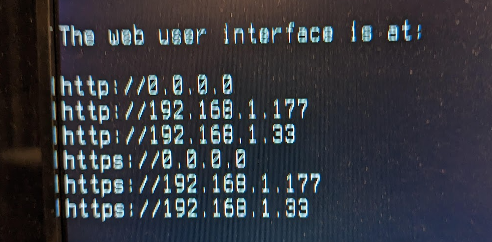

I did the tests, at least i tried..
I encountered very strange behaviour around here. Not quite sure what to make of it.
I ran iperf one more time, same results.
Connected the fiber straight to the NAS, but could not get it to work.
(i think? i changed the default gateway from my router, to the ip of my desktop. that's it on the NAS side. On the desktop, set a static ip, that's it.)
So i reverted every setting i did on the NAS side and desktop side.
That's when the ghosts started appearing..
So, not only i cannot for the life of me connect to anything on my network from my desktop.. But i can go to youtube etc.. (iperf, ping to google, literally nothing works, except browsing normally?)
I cannot go to my switch, nor the Truenas webgui, literally not a single device..
Rebooted every device off course, but cannot get anything to work.
Changed my desktop connection to my 1Gbe connection, everything works..
So i'm further away than yesterday :frown:
I took this screen from the console:
Normally, only the .33 adress should be there. But i cannot clear this.
I tried following:
- "ifconfig (every interface) down"
- "ifconfig ix1 up" -> ok, shows above screen
Tried, using igb0 and inserting my copper gbe link, disconnecting every other connection, no luck. Same screen persists.
I still cannot access the webgui on .33 (or .177), but plex seem to run fine.
Only thing i think that could be messing with the system is my adguard server? I cannot access this either.
So my desktop wont run the 10Gig fiber, needed to revert to copper Gbe to get things somewhat running.
My NAS is the exact opposite.. Won't run the copper Gbe, but insists on the 10G fiber.
Multiple switch reboot off course, and averything up and running accourding to the Mikrotik's dash, and my Asus routers dash. (also rebooted).
For now, i'm going to let it rest.. before i go nuts..
jgreco
Resident Grinch
May 29, 2011
18,680
Well, there's something terribly wrong because you appear to have two interfaces on the same network. That causes all sorts of problems.
Matthias
Mar 7, 2014
81
I know, right?
Though only the copper or fiber was connected, along with the ipmi slot from my mobo.
I'll try again disconnecting the ipmi.
