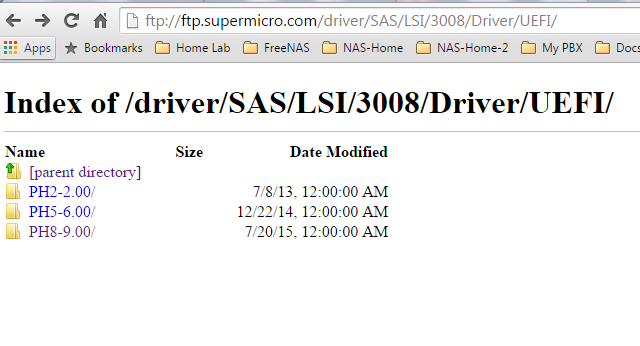

Just so I'm clear - p9 = PH8-9.00 right?
ftp://ftp.supermicro.com/driver/SAS/LSI/3008/Driver

Looks like the supermicro firmware is still a version behind (the latest is v8 from Jul 2015). Any idea if I can use the LSI 9300 firmware to update on the on-board 3008?
I used ftp://ftp.supermicro.com/driver/SAS/LSI/3008/Firmware/3008_FW_PH8_072015.zip
