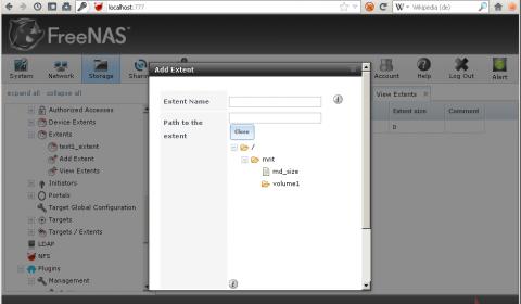

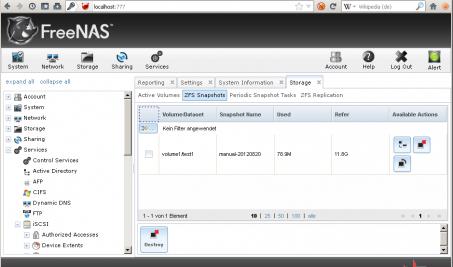

Ok, now I could try it again.
This attachment shows the snapshot of my ZVol: freenas-snapshot.jpg
This attachment shows that I can not find any file representing the snapshot: freenas-extent.jpg

But when I manually enter /dev/zvol/volume1/test1@manual-20120820 into the "Add file extent, I get the error:
"You need to specify a filepath, not a directory."
