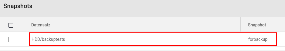

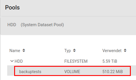

For testing this scenario we created another small ZVOL (backuptests), mounted it on the productive server, created some files on it and did a snapshot in the TrueNAS GUI:

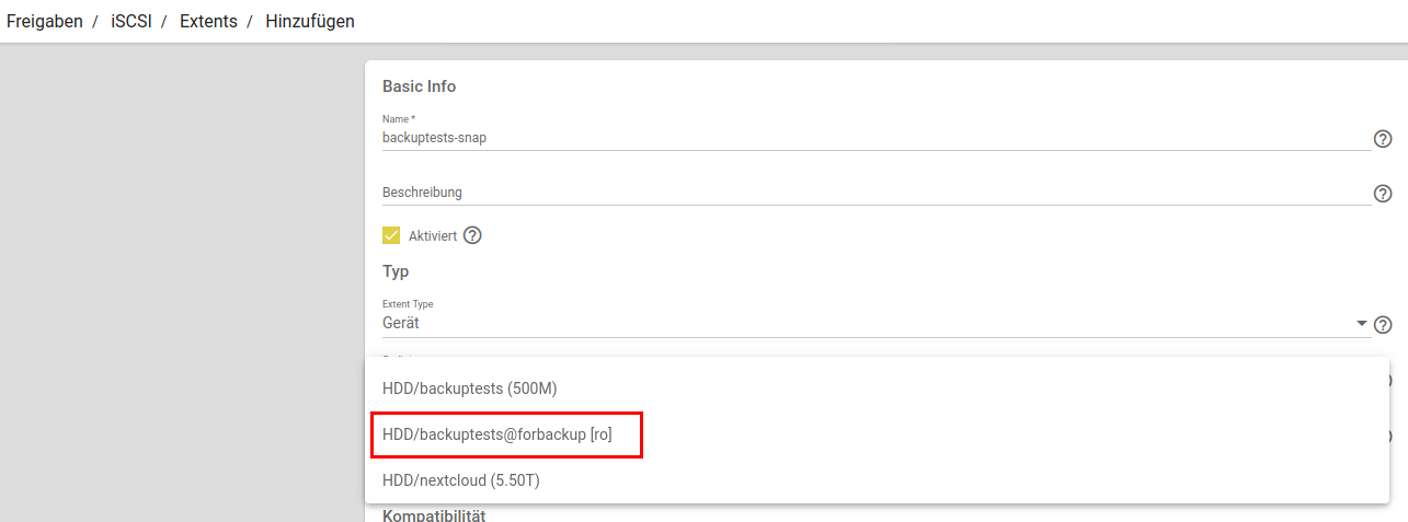

Now we are at the point to share this snapshot via iSCSI in the TrueNAS GUI, which doesn't work... in the extend dialog TrueNAS shows the Snapshot Volume (as ro, of course, which is quit ok):

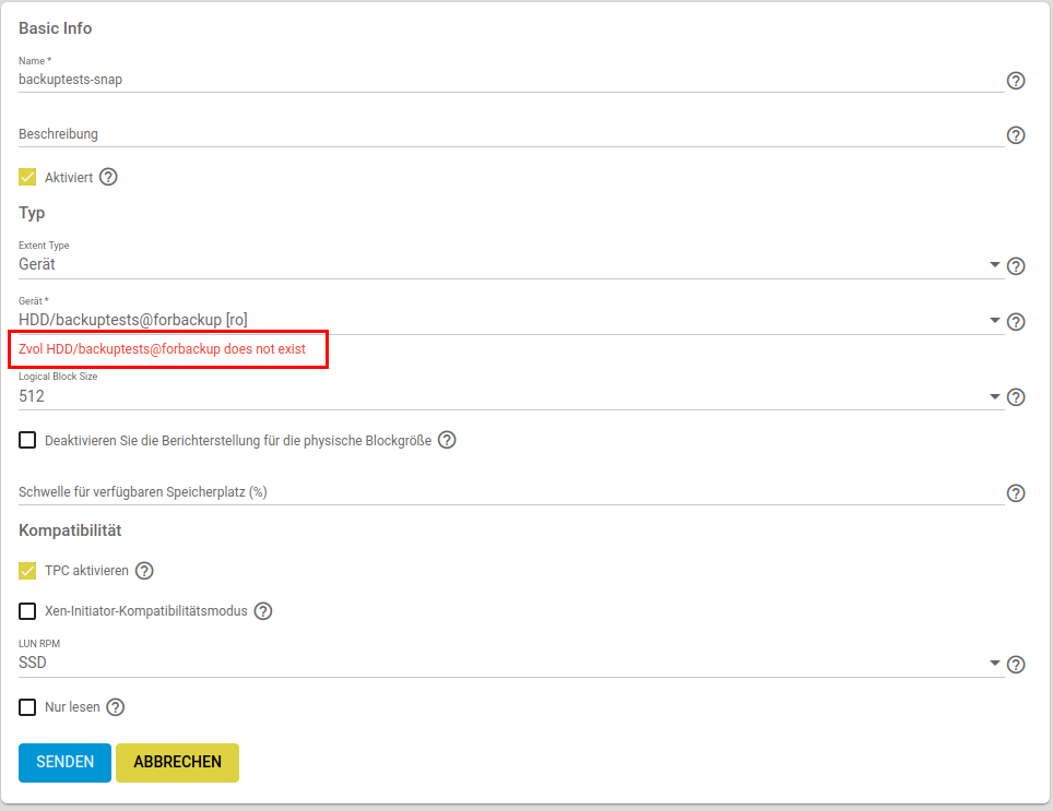

but when clicking on "send", an error appears that the ZVOL doesn't exist:
What are we doing wrong? Can't zvol snapshots be shared via iscsi despite they are shown in the dialog? Or is this scenario completely nonsense at all?
As iSCSI Vols should / can only be attached to one single server we thought, sharing a snapshot as "new" vol would be a way...

I don't think you can share snapshots with iSCSI. You would need to clone the snapshot to get something that can be shared... You should also then look into the complications of clones. The manual doesn't talk about ZVOL snapshots and clones being the same or different and says you can clone, use, then delete the clone with no harm to the original snapshot, but I have some concerning memory of reading something about deleting clones could delete the original somehow (not sure what I'm really saying here other than be careful).

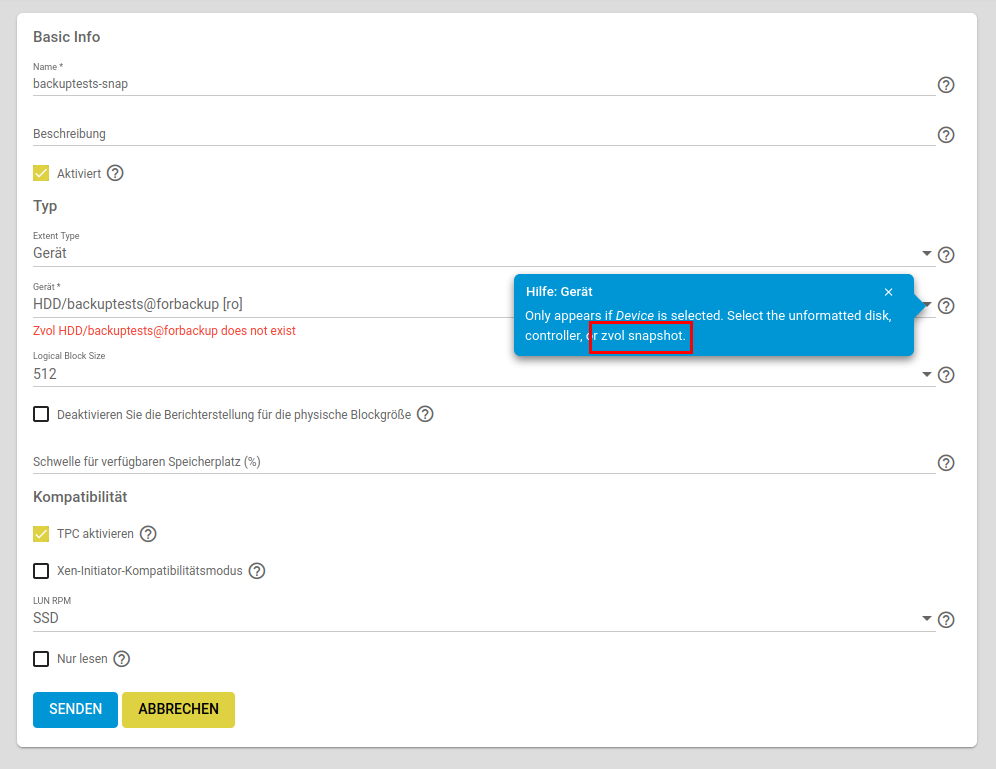

But what I'm wondering is: why can the snapshot be found in the Extend GUI's device - dropdown? And as a plus "snapshot" is also mentioned in the help text:

It's working on 11 edition, but after upgrade to 12 I have got the same error. I think it's a bug~ I need to share zvol snapshot as iscsi target/extend.
Is someone in TrueNAS working on it? I also have the same error - when I choose the Deivce as snapshot [ro], I get the error that "Zvol ... does not exist" and actually indeed in /dev/zvol/... there is no zvol for a snapshot.
Anyone knows how to activate a zvol for a snapshot?
9,700
I think you're looking for zfs clone
